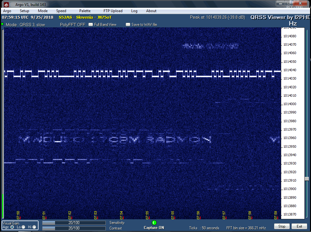

Testing the QRSS beacon tonight in Hellschriber on 10.140Mhz. Hoping to see it on a grabber somewhere...

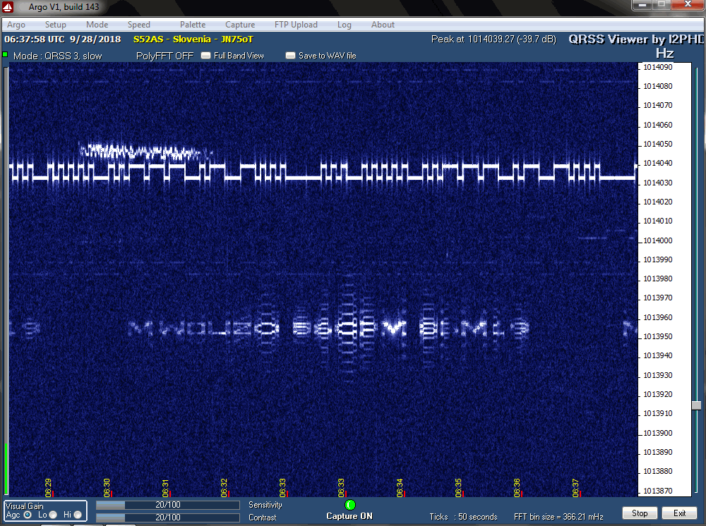

Got another capture this morning. Looks like there is some distortion... I had left the processor on on the radio!
Trying again w/o processor. If distortion remains, the output volume may be too much or non-optimal from RadLog.

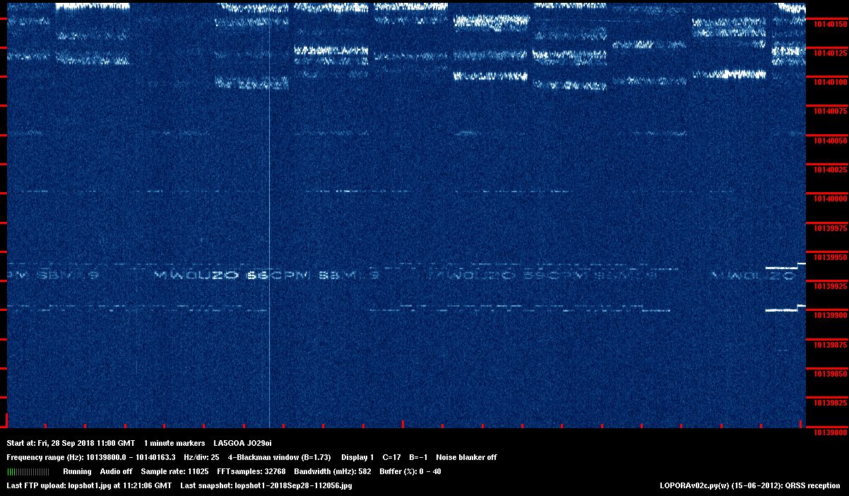

Capure! - LA5GOA
