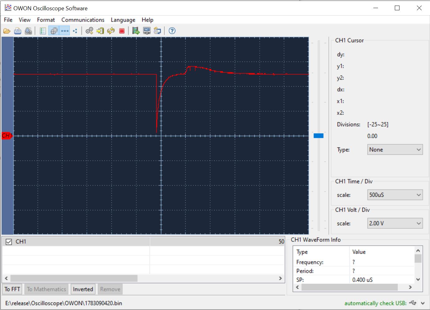

Hello All,
I have been trying to get my ESP8266 counter sketch to work properly on the ESP32. It seems to count too many times when the interrupt is triggered. I'm using my development Geiger counter (a GK v5.5 circuit on breadboard) which has served me very well with all other MCUs I have tried it with, but not the ESP32.
At first I had the 5v output going straight into pin 23 of the ESP32 (see first oscilloscope waveform) and whilst it worked, it would count 3-4 counts every time the interrupt was triggered. After some trial and error testing (changing the internal pullup/rising/falling - nothing worked) I dropped in a 5v - 3.3v level shifter on the counter output to drop the level to what the ESP32 would be more comfortable with (see second oscilloscope waveform) and whilst it did reduce the false triggers, I am still getting two counts per pulse. So then I wrote a very simple debounce routine and that really helped a lot. A debounce of about 25us (microseconds) works well and at background counts the ESP32 is reading 1 count per pulse. Great?.... No so... By introducing the small debounce timer this is having a detrimental affect at higher counts per minute/second. So when testing with a LND712 and Amerecium 241 it seems to now be missing counts at the high end. I have a Pro Mini connected at the same time as the ESP32 to compare and the Pro Mini would count say 20,000 counts in X seconds, but the ESP32 would count about 14,000 counts in the same X seconds.
I have very little experience with the ESP32 (this is the first time I have ever used one) and I am at a complete loss as to resolving this. I don't understand why it would be picking up two counts from the 3.3v pulse as it seems clean. I have looked at some other ESP32 counter code and seems nobody else is using a debounce on the input, so is it my ESP32, or are the other people's sketches counting too much also? I have some more ESP32 on their way to me from Aliexpress, but I think until I get one of those to try I am going to shelve this for now util I can try with another ESP32 or find a solution somewhere. I have included the full code below. (The code is just set to print total counts, not CPM, for diagnostics.)
Waveform of 5v pulse - This gave approx 4 counts per pulse:
Waveform of 3.3v pulse - This gives approx 2 counts per pulse unless debounced:

I have been poking and prodding at this all morning and still getting nowhere. I used jesterer's test code above, but thinned it down a little to just count and display every second to test the interrupt. The test code I used is below. Still no joy though, and still counting erratically.
I have done the following:
I have made a small video on this happening FWIW.
This is the test code I used:
- Tested with small test sketch instead of my larger code
- Tested with different pins - 12, 13 & 23
- Tested using RISING and FALLING interrupt parameters
- Tested with two different ESP32's - One a WROOM-32 and one WROOM-32D
- Tested with two different Geiger counters - My breadboard GK v5.5 which I have used to test many other MCU projects, and never had this issue. And a cheap CAJOE RadiationD v1.1
- Tested using a logic level converter between the counter pulse and the ESP input pin - This does clean things a little, but not 100%

Replied by Bert490 on topic Struggling with ESP32 - Counts too many - Interrupt issue?
Maybe the interrupt is firing close to the steady state voltage, where there may be more noise. Since the level shifter helped, maybe a different one might be better; I'm thinking a comparator chip set to 2V. Then the negative-going input will cause a positive output, but narrower. Chances of bouncing are less, and if they are still present, maybe an analog debounce of 10 uS with a small capacitor. That would save one addition operation in the ISR and maybe improve accuracy at higher counts.
