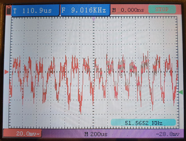

Right before I post this I just checked the PSU that is running two counters with my scope. It was quick and easy to at least check the 5v rail. This is post 7805. So I'm checking the ripple after the 7805, and it's bad. 30mVPP. It's messy also, as you can see in the picture. I didn't check the 12v side, the actual PSU output, but 30mv ripple after a 7805 is completely unacceptable. I think a linear PSU is really the best way for me.
