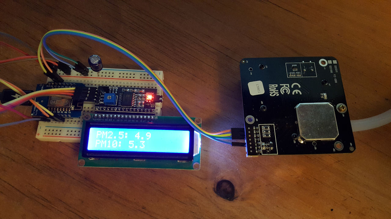

I've been working on this over the weekend. I have a working model that samples and logs every 5 minutes into various .csv files that are used for drawing graphs. It is a work in progress, still much to do. Take a look here: http://www.dreamtechnologies.co.uk/airquality/
Please ignore the data as it is not accurate as is just for testing purposes at the moment. I'll be dumping the collected data and starting from scratch when I get this into an enclosure and mounted properly outside.
The hardware is very simple. An ESP8266 (Wemos D1 Mini), I2C LCD driver, 16x2 LCD and a Nova SDS011 PM2.5/PM10 sensor. The software on the ESP8266 simply wakes up the sensor for 20 seconds along with the built in wifi, then records the last sample, puts the sensor to sleep for 5 m inutes and shoots it to my web server where some PHP does the magic and writes the log files etc. I'm pretty happy with it so far.
Along the road of making and programming this it has become apparent that an open system (like Radmon) is a very big task. Much larger that I had originally thought. While doable there are some fundamental things I need to address in order to make an open system as reliable as possible. It would require such things as error checking to make sure the data is correct on transmission/reception (implement a checksum?) etc. For now, I'm going to get my personal system tip-top, then maybe look at opening it up later for other users. I'll see what other people think about this.

Looks a very interesting project. I have the ESP8266 and a 128x64, 0.96inch OLED screen from another project which could be used on this. I estimate that you could probably buy all the necessary hardware and a case for about 40 pounds sterling?
