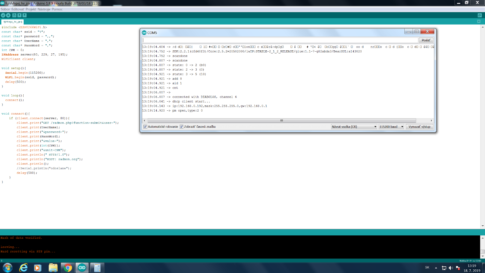

And my code is well written and set?

Hallo.
The problem is that the radmon page is HTTPSecure and ESP has only an unsecured HTTP library
7 years 1 month ago - 7 years 1 month ago #4495
Replied by mw0uzo on topic NOT Procedure to send CPM value to radmon
Hmm, I don't think its that as radmon.org works over unencrypted http. Data should still be able to be sent using standard simple methods so small computers like Arduino and DIY kits still work without lots of hassle. And the site is accessible on old computers/platforms.
Has anyone else had problems with their Arduino/BroHogan/DIY kits where the unit communicates directly with radmon.org and not via PC?
