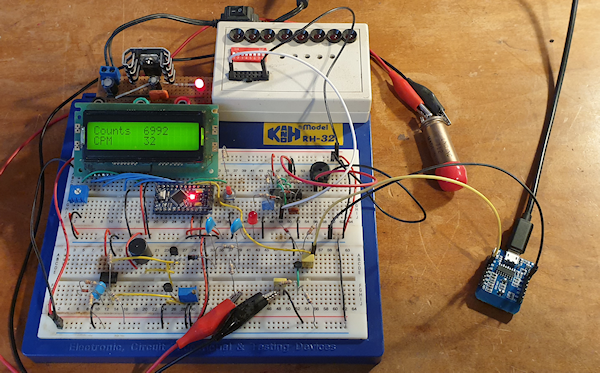

And finally, this is what I used to write and test the code with.

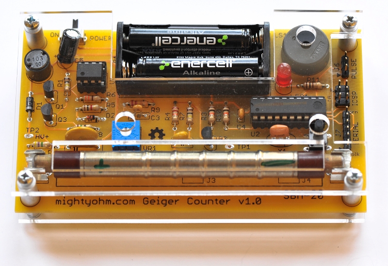

I currently have my Migthyohm Counter connected locally via MQTT. My counter delivers the data string in this form via serial connection:
CPS, #####, CPM, #####, uSv/hr, ###.##, <mode>
My programming skills aren't the best, so I'm having problems transferring data with the Rademon interface.
I may have made mistakes here.
There is already an error in my MQTT preparation, where I cannot transfer the mode.
I have another error when transferring data to Radmon. Could you see my Arduino configuration?
Thanks
Chris
I discovered your instructions here on how to do the data preparation and transmission to Rademon using the ESP8266 Wemos D1 Mini.
Thanks
Chris

Can you please explain some more about your setup? The Mightyohm counter uses an ATTINY micro controller that does not have WiFi capabilities, so that will never be able to send data to Radmon on it's own. Do you have an ESP8266/Wemos D1 Mini? It would be much easier to simply run a wire from the 'pulse' pin on the Mightyohm counter to D7 on the Wemos if you do have one. That would allow you to send to your local MQTT server and also send to Radmon and would require no changes to your code and simply run my code on a Wemos. That is, if you have one. Let me know a little more about your setup and I'll try to help.
Cheers
Simon
Cheers
Simon

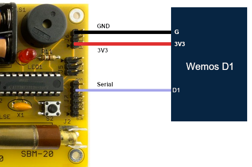

Hi Simomax.
My Mightyohm Counter was connected to a Wemos D1 Mini.
I would just add the radmon part as radmon.h.
The existing scripts are the Wifi part and the MQTT part.
Attached are the existing scripts.
I imagined this as putting the radmon part in the radmon.h file, and linking that file to the base part.
The next step is to add an i2c display.
As already mentioned, I still have an error in my scripts with the mode evaluation of my counter. The part CPM, CPS and uSv/h work.
Thanks
Chris
Thanks
Chris

Thanks for your pictures and code. I understand now how your system works. Mightyohm counter sends serial to Wemos and then the Wemos sends to MQTT. However, what you have written for Radmon won't work. You will need to include the whole http function. I.e. all of the 'void updateRadmon()' function. You will also need to add the variables the function uses, such as the host name, user name, password etc. Also, there is nothing calling the function within the loop. You need to add some timer in the loop to call the function every x seconds. Minimum 60 seconds for Radmon. You don't really need to add the Radmon part as an include file. It could be written into the main code and then add the variables in your settings.h.
It would be quite easy for me to add the Radmon part to your code if I could test it, but I don't have a MQTT server so I wouldn't be able to test reliably. I also don't have a Mightyohm counter to supply the serial data to the Wemos which poses a challenge.
Cheers
Simon
Cheers
Simon

Hi SimonI understand that a function test regarding my counter is not feasible for you, but I can then do the tests on my counter.
Since I am still in the process of completing the MQTT interface and am planning to add a display, tests are not a problem.
Some information can also be found under this link.
https://myscope.net/geigerzaehler/
I implemented the serial interface with MQTT with the Wemos D1 Mini. Where I still have an error is the parameter mode over the serial interface.
The readings are passed in a simple CSV format:
Chris
CPS, #####, CPM, #####, uSv/hr, ###.##, <Modus>Chris
