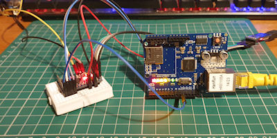

3 years 8 months ago - 3 years 8 months ago #6315
Here is some Arduino code for the Arduino Uno, Mega2560 and Pro Mini with WizNet W5100 ethernet shield. This is bare-bones code only. It does only these things: receives pulses on pin 2 (Uno, Mega & Pro Mini), calculates CPM and submits it to Radmon.org (via ethernet shield) every 60 seconds. It has a little debugging that can print to serial and I have also added CPM print to serial (much like the NetIO GC-10) that can be used with the Radlog windows logging software - and that is it. Nothing more, nothing less. It works. I used my own custom code I had previously written for other devices and pulled snippets from the internet for the ethernet shield.
To use this you simply connect pin 2 to your Geiger detector, load the code and change your radmon.org username and submission password, and that is all.
NOTE: Make sure the pulses coming from your detector are logic level <= 5v or you may destroy your Arduino, or damage your detector circuit, or both. In testing I used my Geiger Counter development (bread)board which is basically a copy of an early GK geiger counter (thank you Brohogan for making it open source - much appreciated!) You may need additional electronics to interface your detector to the Arduino which is not covered here.
Here is the code:
When running properly you should see it startup and start to detect events in the debug log like this:
When it submits the CPM to Radmon.org, you should see this in the debug log:
If all is well and you want to use the serial CPM output then simply turn off debugging (debug = false) and enable the printCPM (printCPM = true). You will then get a serial output that can be used with other equipment, or the Radlog windows software, and should look like this:
Be Happy!

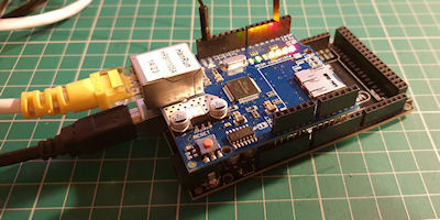

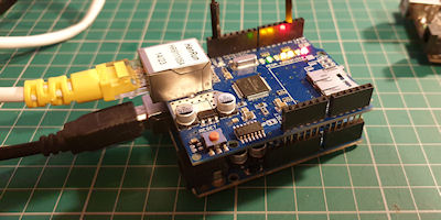

3 years 8 months ago - 3 years 8 months ago #6318
Replied by Simomax on topic Arduino Uno, Mega2560 & Pro Mini + WizNet 5100 ethernet shield - Bare-bones code
I have just tested this with an Arduino Pro Mini and it works well.
The ethernet shield I am using is a cheap clone. The only pin 10 is connected on the side connectors. Pins 11, 12 and 13 go to the ICSP connector on the shield. This caused me much confusion for far too long! I'm not sure if the original is the same as this, but something to look out for. I also ran the 5v and ground into the ICSP connector, so just pin 10 was connected on the side connectors.
Now on to Arduino and Mini ENC28J60 ethernet adapter!

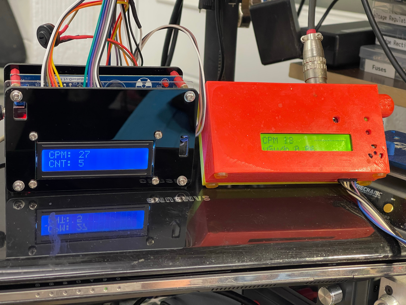

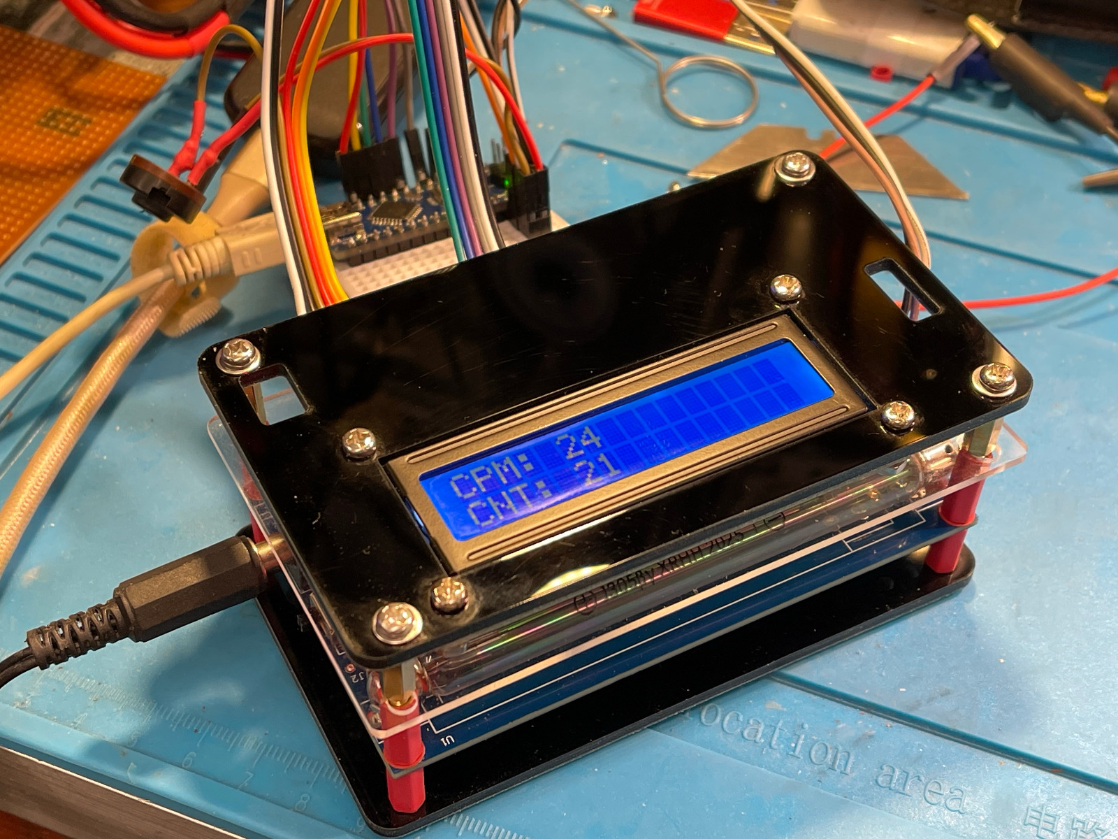

Old thread but nice work anyway. I just tarted up my Cajoe with an Arduino Nano + LCD, and cut a black acrylic cover using my 10W laser engraver. Still looks messy with bits hanging in the breeze but I've already changed my mind about using the Nano and ordered some ESP32 boards with built-in OLED display. That can connect via WiFi without further hassle.

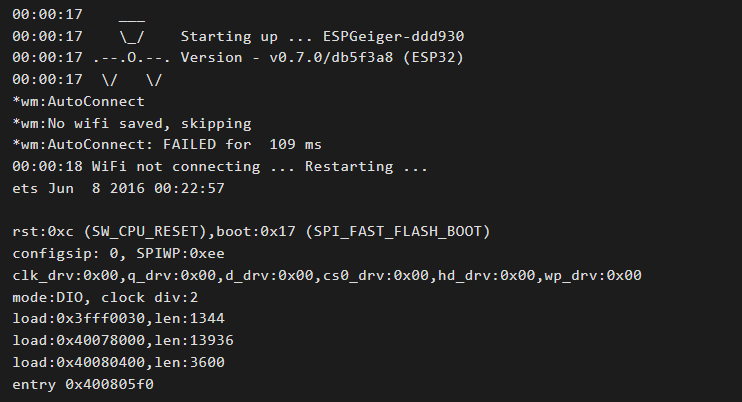

Edit: OK, I got it to upload the firmware - I wasn't holding down the boot button long enough.
However, after reporting success the ESP32 remains apparently lifeless. Nothjing on the OLED. Looking at the console I see it is just looping due to not having a WiFi connection? The ESP32 is not creating a hotspot like it's supposed to... I'm using ESP-WROOM-32 devices...
Edit: Wits end on this one. Beginning to think these cheap AE ESP32 boards are garbage. I have tried all options posted about getting this working - including cloning the github repository and compiling the source myself. No luck. I'll order a name-brand ESP32 board off Amazon to try, but if anyone has recommendations as to which boards will actually work (and are available) please post.
Replied by ChrisLX200 on topic Arduino Uno, Mega2560 & Pro Mini + WizNet 5100 ethernet shield - Bare-bones code
I've got my ESP32 boards now so am attempting to connect the one functional CAJOE board I have. Still waiting on delivery of the other two. There seems to be a lot firmware(s) available for different devices but I assume the one I want is the Pulse variant for the Cajoe. I already tried a few others before I figured that out! Anyway, I can't seem to get past the 'prepraring the installation' screen in the Chrome web install. It just sits there. The install routine has found the ESP32 ok (COM21 on my setup) and I've tried holding the Boot button down while clicking on install. I;ve also tried resetting the ESP32. I may try installing the downloaded bin file with a dfferent utility if this doesn't work. It looks good though if I can get it to work and will make life a lot easier uploading the data to Radmon.If you are going to use ESP8266 or ESP32 then take a look at ESPGeiger: https://radmon.org/index.php/forum/arduino/1312-espgeiger - It rocks. I have worked with Steadramon quite a lot with ESPGeiger, although more with the ESPGeiger HW hardware side of things, especially it reading the tube voltage on the fly. Only the ESPGeiger HW does this though, not the other flavours of firmware. If there are no special needs cases for your counters, then it is a very simple drop-in-place solution for submitting to Radmon, MQTT and a couple of other things. Sadly, I do have a special needs case so before I can use it on all of my counters, I need to wait for some extra code to be written for it, although it seems development has slowed to a crawl. I may end up just hacking my own code onto it somehow if Steadramon doesn't include a generic web hook.
