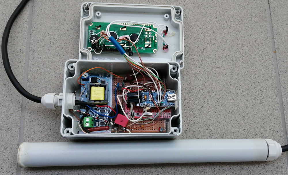

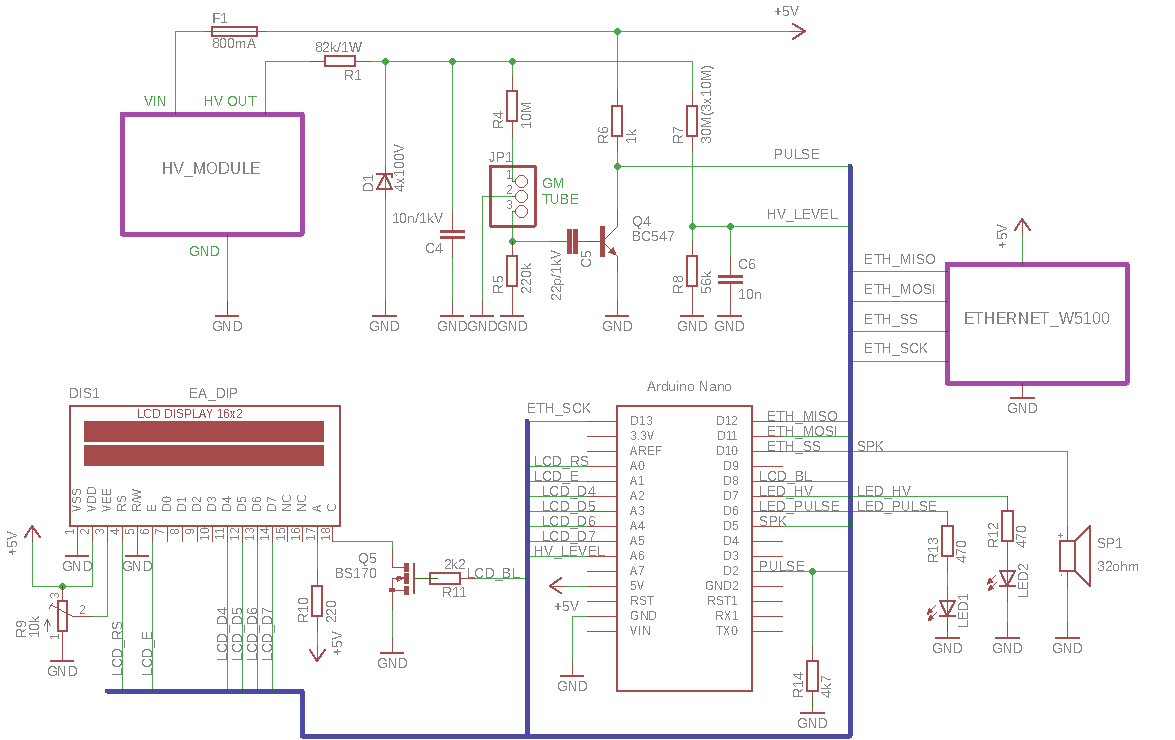

Hello,
here is my GM counter with online data logging to Radmon server.
Used Arduino NANO with Atmega328 and Wiznet W5100 module.
GM tube Si22g
Link:  GM čítač s prenosom na WEB (pablox.net)
The following user(s) said Thank You: Simomax, nu3e
3 years 3 months ago #6459 by Simomax
Awesome, nice work! Tidy and compact. Thanks for sharing the circuit.
