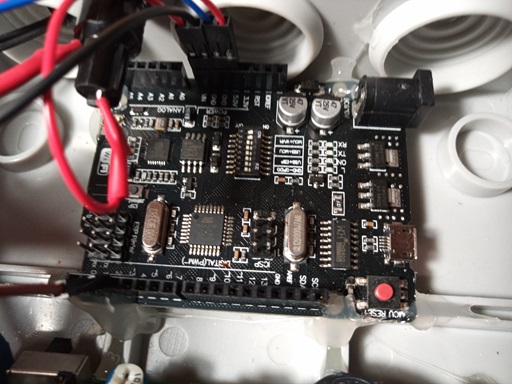

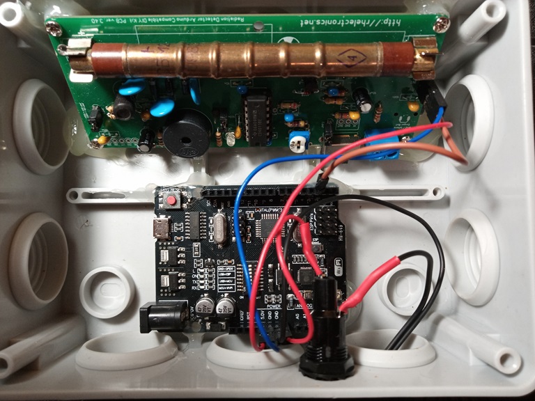

For sending data to radmon.org I am using ARDUINO UNO with integrated WiFi ESP8266. There is needed two codes, one for ATMEGA (arduino part) and second for ESP8266 part.

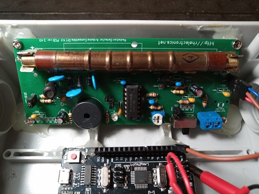

As a Geiger-Counter I am using Radiation Detector RH Electronics, but is possible to use also other counter (see details in code comments).
 * This code is written for Arduino clone Uno with integrated WiFi ESP8266 for sending CPM to radmon.org via WiFi
 * This code is for ATmega328 (another one is for ESP8266)
 * I am using "Radiation Detector Arduino Compatible DIY kit ver.3 from rhelectronics.net - connected D2 pin as input to Arduino - but it will
 * work also for another "Geiger Detectors" - just use D2 pin as input (LOW)
 * As reference I used code from RHelectronics page (Thank You!):
 * https://www.rhelectronics.store/radiation-detector-geiger-counter-diy-kit-second-edition
 * and add communication between ATmega328 and ESP8266
 * Vladimirovic
