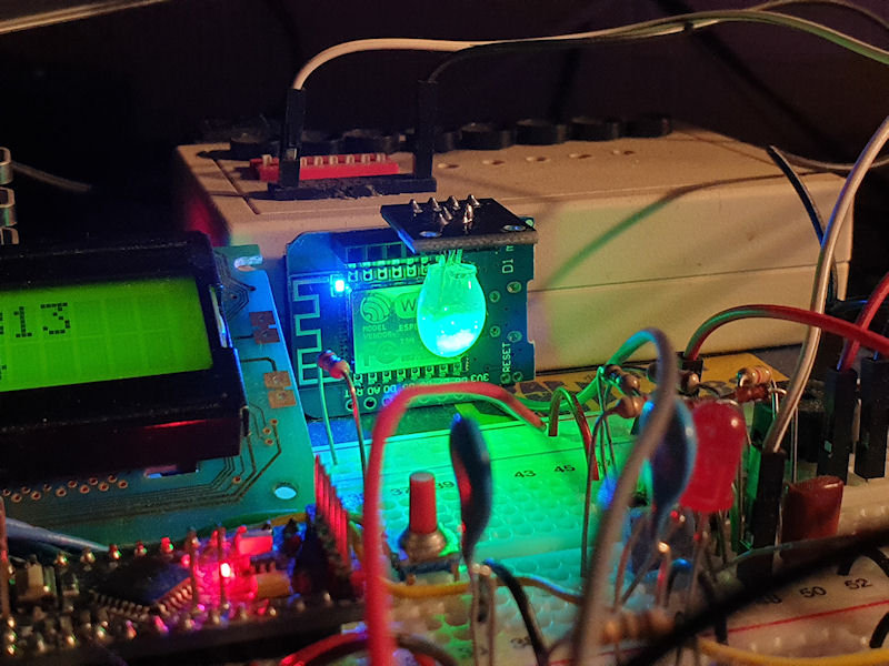

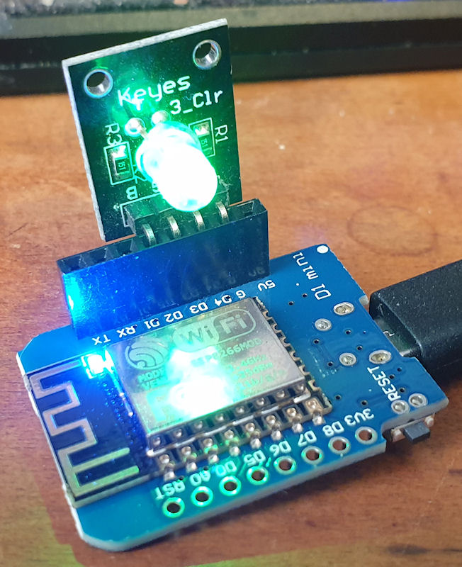

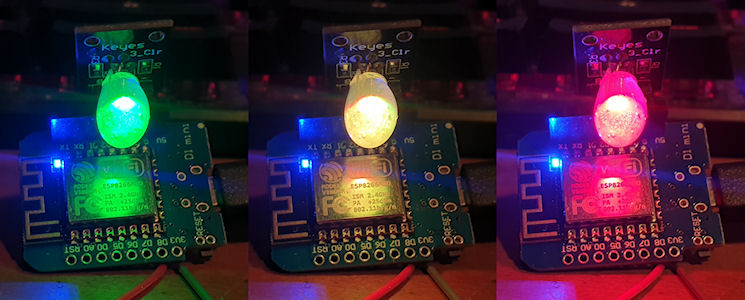

I knocked up a simple monitor to easily see if radmon.org is up or down. It uses an ESP8266 (Wemos D1 mini clone) and a single RGB LED. It simply polls radmon.org by asking for a response from the server. If it gets the reply it is expecting in a timely manner it lights the LED green. If it doesn't get the reply it wants, or times out, the LED changes to orange and sets a fail counter +1. If it receives the correct reply again it goes back to green, but after 3 consecutive failures the LED lights red. There really isn't much more to it. There are positions in the code where an alarm or something else could be activated and also deactivated. It has two modes - lightweight or not. In lightweight mode (lightweight = true) the monitor calls a simple HTML page with the text 'pong' in it. The other mode (lightweight = false) sends a query to the radmon api and the request is processed by radmon core. It then chucks out the same 'pong' for the monitor. The latter method uses more CPU cycles so unless some specific testing is being done the lightweight mode works fine.
The LED is one from a kit or something. It has the resistors already on the PCB with the LED, so make sure you use the right resistors for each colour of the LED if you decide to make this. The LED was very bright (clear type) so I threw a splodge of hot glue on it to diffuse it. Now it looks a little like a small glowing grape as it sits at the back of my breadboard!
