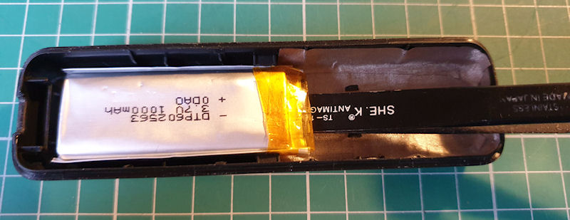

I had to replace the battery in my Radiacode 101 as it was becoming potentially dangerous. I noticed the main button on the Radiacode wasn't pressing in properly and was sticking at times, so I popped the unit open and found the battery had expanded and was putting pressure on the circuit board, and thus making the button tight. The battery hadn't expanded like other LiPo's I have had, where they become springy and spongy (gas being released into the battery packet), this had expanded and was rock hard. Iv'e never seen that before. I didn't like it, so immediately removed the battery from the device (and that was a proper load of scary fun) and put it outside. I take no chances with LiPo's when they start to expand. It is a sign that the chemicals in the battery are getting unstable and starting to off-gas. I got the Radiacode sometime in 2021 so I reckon the battery has lasted for about 3 years. It was probably at about 50-60% capacity as I was having to recharge it about every week. When I first got the unit I charged it about every two weeks. It's not done bad, but I think could have done better. I think my phone fast charger may have shortened it's life a bit and it was starting to get hotter than usual when recharging using the phone charger. I think I'll use a 500ma basic dumb charger from now on.

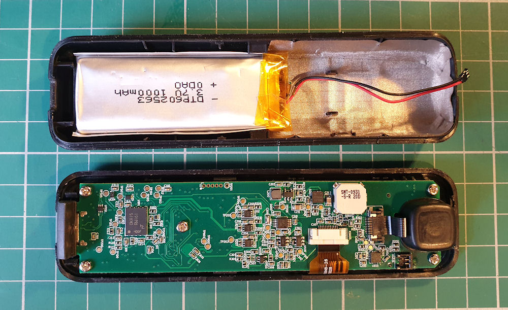

First power off and open up the Radiacode 101. The case is clipped together very much like a TV remote control so use a good spudger, and it seems easiest to start prying in the middle of the case at the sides and working towards each end. This is my favourite type of spudger for these kinds of cases (not this particular make, but this spring steel type.) Eventually it will pop open when all the clips are released. Be careful as the battery is stuck to one part of the case and the PCB the other part of the case. Once open disconnect the battery connector from the PCB by tugging gently on the cable. Then put the PCB part over to one side where it can't be knocked or damaged.
Next is removal of the old battery. Grab something hard and blunt, slide it under the bottom of the battery and start to pry it out. In all honesty this was scary and I wasn't comfortable doing this at all. But it was either grin and bear it, or loose my Radiacode. At first I tried to prise the old battery out in the house. The battery was stuck tight and needed levering up bit by bit to undo the sticky adhesive pad. As I was prising it out the battery was bending a bit. Not good. I didn't like that at all, so I chose to do this outside instead, wearing a pair of welding gloves in case it went up in flames in my hands. Eventually after much persuasion prying it up with the blunt end of a pair of tweezers it popped out, kind of wrinkled and a little bent, but it was out.

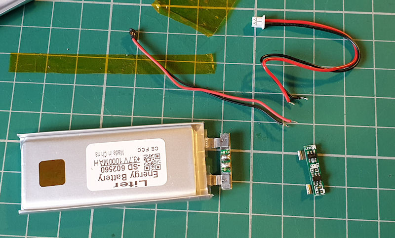

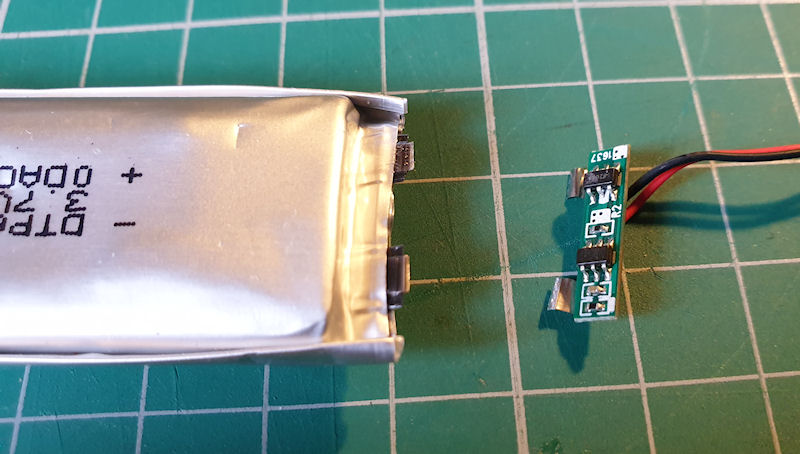

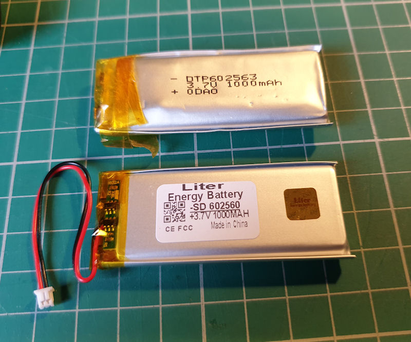

Once the old battery out, if it didn't burst into flames or explode, remove the wire from the battery as close to the battery as you can. This is going to be reused on the new battery. I chose to just cut the protection PCB from the old battery and desolder the wires from the small protection PCB. The Kapton take will have to be removed to gain access to the battery terminals in order to cut them. Or the wires could just be desoldered with the protection PCB in place. Be careful not to cause a short circuit.

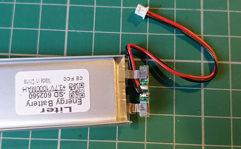

Grab the new battery and carefully remove the Kapton tape as it is going to be reused. Unfold the protection PCB to gain access to the underside where the wires are soldered on.
Very very carefully desolder the wires taking much care not to cause a short circuit.

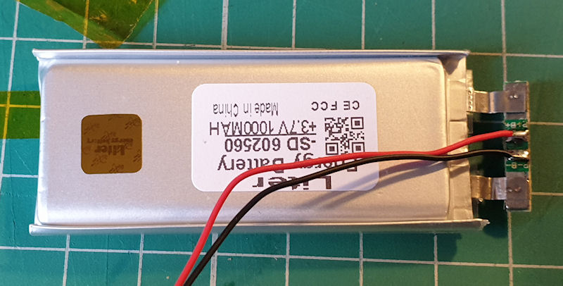

Then solder the original wires on to the protection PCB (attached to the new battery), again, being careful not to cause a short.
And finish up by sticking the Kapton tape back on and fold in the protection PCB.

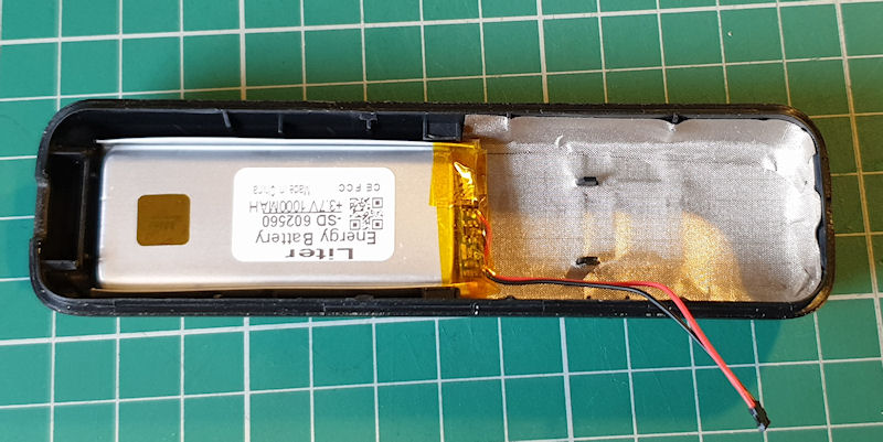

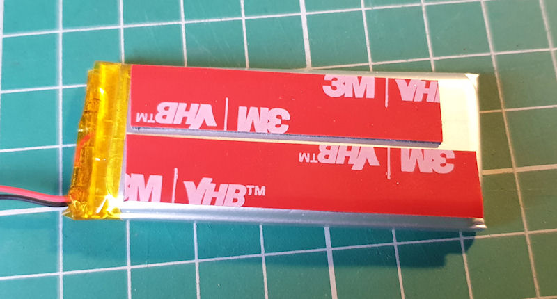

Next apply some of your favourite double sided sticky stuff to the underside of the new battery. I used a quality 3M automotive adhesive foam tape. Don't use hot glue. LiPo's don't like much heat.
Without peeling the backing from the adhesive tape, place the battery back into the case and check the fitment. Make sure it is firmly down in the bottom of the case. If the battery is fitted poorly the components of the Radiacode 101 may puncture the new battery and give you a really bad day. Once a good fitment is observed, remove the new battery, peel the backing from the tape and stick it down in the case. A good even, firm press down is all that is needed. Don't do anything to distort the new battery.

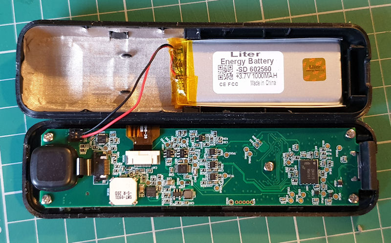

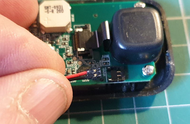

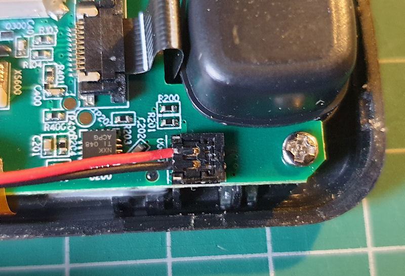

Next, grab the other half (PCB half) of the Radiacode and connect the battery. Note the battery connector pushes down from the top. It does not slide in at the side. Looking at the connector it would seem it does slide in, but it doesn't.
Line the connector up on the top of the socket and it should very easily pop into place. If you have any resistance then check the alignment and that you have it the correct way around. The positive goes towards the middle of the PCB, and the negative the outside of the PCB.
Once the battery is connected have a good look at your work and smile at the fantastic job you have just done, and that you are going to get another few years from your Radiacode.
Once you have finished inspecting your handy work, simply pop the two halves of the case back together and job done! Nice!

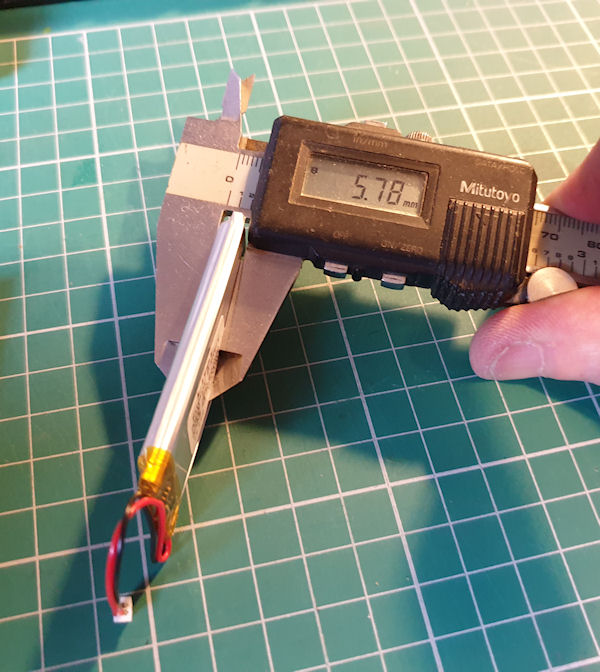

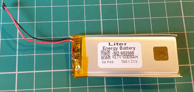

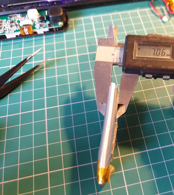

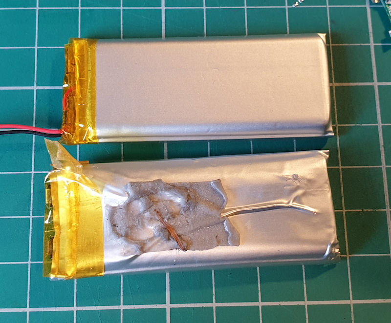

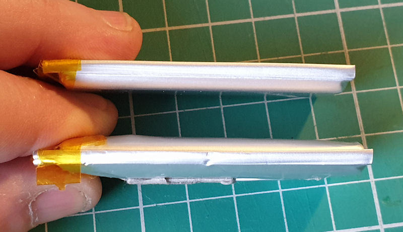

Here are some pictures of the old and new batteries. Note the vernier measurements. The old battery should be 6.3mm and the vernier is showing 7.06mm. It has certainly grown over time.
