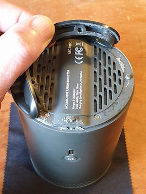

First off is getting into the bugger. They don’t really want you inside this thing. The case is clipped together at the sides, with two screws at the bottom under a rubber-baby-buggy-bumper that is glued in place. I’m guessing a line between not letting anyone inside and keeping the unit serviceable. A bit too much brute force could rip of destroy the rubber-baby-buggy-bumper. I had to tease it off very gently using a flat screwdriver, lots of force and a bit of time. Eventually I had gotten enough of it back without breaking anything and revealed the two screws. Take out the two screws then crack it open by squeezing it, and use a spudger to pop open the clips – two each side. After disassembling and reassembling a few times, it becomes quite easy to just squeeze in the right place to pop it open. Once a couple of clips are free it is much easier.
After opening it comes apart into three pieces – two halves of the case and the ionization chamber. The chamber is connected to the mainboard with a small JST connector. It has a squeezy lever to unlock the connector and it will disconnect fairly easily. The battery is also connected to the mainboard and it would be prudent to disconnect the battery and put to one side if playing about with the insides of the unit, unless you needed it powered on. Those INR21700 batteries can give out a huge amount of current – so don’t short it or you will have a really bad day.

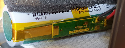

The battery is (by the looks of it) a genuine Samsung INR21700/50E, the specifications are:

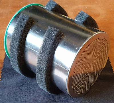

Now the chamber. Not particularly unusual to me. It isn’t dissimilar to ion-chamber radiation meters such as the CDV-715. This works on a pulsed output, much like GM tubes, so should be fairly easy to mod. The chamber is open to the air but I am unsure of the exact mode of operation. I have a feeling that some kind of charge accumulates, and then when it gets so much, it ionizes and creates a pulse. I have had some quite strange effects with it either not counting or counting too much, but generally when I ground myself and the chamber whilst reassembling this reduces funniness a lot.
The chamber measurements:

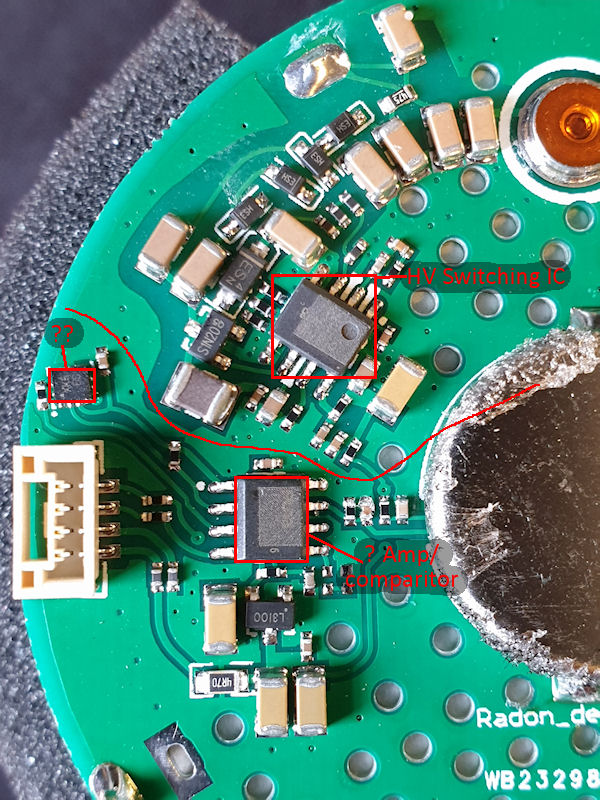

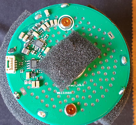

This is the PCB on the rear of the chamber. The top part is the HV stage and the lower part is the detection/pulse stage. There is an unknown IC that neither I nor Lala (AI) can find. I think it may be a stable voltage reference for the pulse – I could be wrong. The other two SOP-8s have had their markings removed. The one at the top in the HV stage is probably a switching IC as it has an inductor to its lower left and some hefty caps. The other SOP-8 is either an amp or comparator, or something similar. The tiny IC is quite unknown.Looking at the connector it’s pins (going from top to bottom) are as follows:

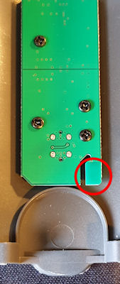

You can see the sensor a little more clearly in the above image. There is a cut-away in the PCB to help insulate the sensor from the rest of the board. The sensor is also mounted very close to the battery, so it may be used for monitoring battery temp, and as this will change during charging so that might be another reason they are not showing the values.

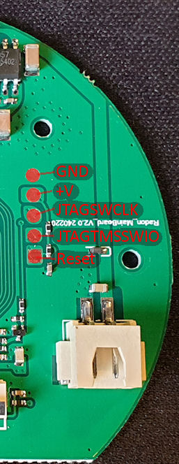

The last bit is the JTAG header pins on the board. And they are, just that.

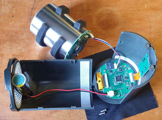

- Model: INR21700-50E
- Size: 21700 (21mm x 700mm)
- Head type (Positive terminal): Flat Top
- Maximum Capacity: 5000mAh
- Typical Capacity: 4900mAh (0.2C discharge)
- Peak discharge rating: 15A
- Continuous discharge Rating: 9.8A
- Nominal voltage: 3.6V
- End-of-charge voltage: 4.20V
- End-of-discharge Voltage: 2.50V
- Rechargeable: Yes
- Protection circuit: Unprotected
- Approximate Dimensions: 21mm x 70mm
- Approximate Weight: 68g

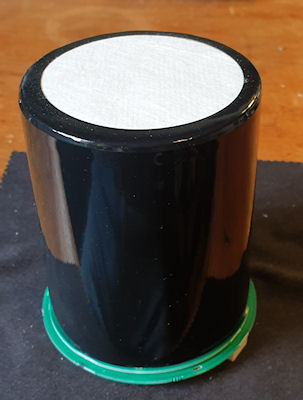

- Diameter - 65mm
- Chamber length - 78.5mm
- Length including PCB - 81mm
- Overall length including metal rear cap - 85.2mm

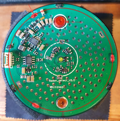

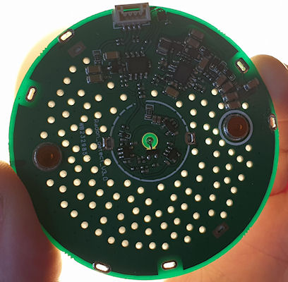

- Pulse out (held high to +3V, drops to ~0.2V on pulse)
- Reference voltage?
- Ground
- +V
The mainboard has a few bits and pieces on it (datasheets linked below). Right at the top is the indicator LEDs (reversed). The MCU is a SWM34SRET6 (ARM Cortex M33). We also have an RTC above the MCU, some ESD protection on the

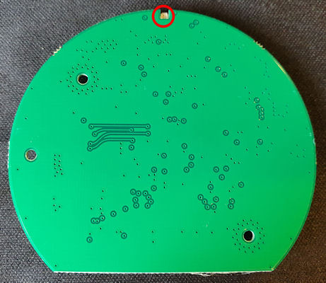

The rear of the mainboard is boring.

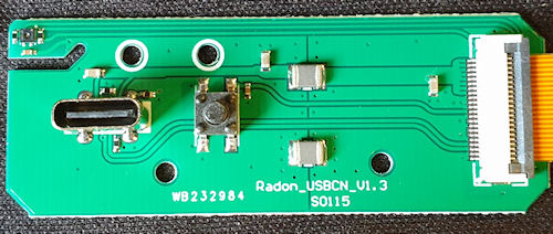

The USB port and power switch PCB. This just has the USB C connector, power button but also a sneaky hidden sensor. The sensor is a temperature and humidity sensor – but the manufacturers don’t have that displayed at all, and I think I know why. At first I had trouble identifying it so Lala (AI) helped. It looks just like a SHT30-DIS (or similar) so I think this may be a copy of the SHT30-DIS (or similar) and because of that they are not including the readings. It shows in the report PDF two fields – Temperature alarm and Humidity alarm, and both show ‘not support’.

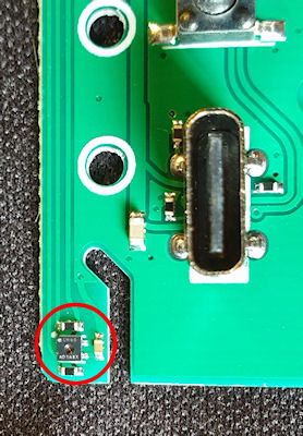

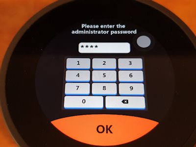

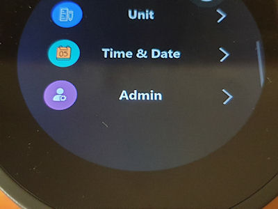

From the 'settings' menu select 'Admin'
It will ask you for a pin code. I worked it out to 0018. I figured I'd start at 0000 and do 50 numbers each time until I found it. It took 18 goes.
Punch in 0018 - press OK.

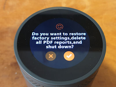

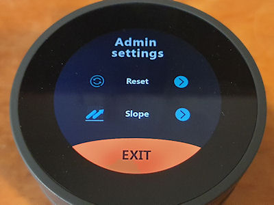

Here you have two options, one for resetting it and one for what looks like calibration.
The 'admin' reset is a full factory reset and will wipe the PDFs too.
The 'slope' menu. It looks like some kind of calibration menu - i suspect here be dragons.

The chamber is interesting. I agree on the IC's likely for HV generation and regulation. The lack of inductors or coils may mean the unit runs at significantly lower voltage. I see a potential for several stages of voltage doubling with the diodes and caps in that area. Still would not likely get high voltage.
I just noticed under that foam bit there appears to be traces running and that could be a larger coil for a flyback. Were you able to determine what is under that foam?

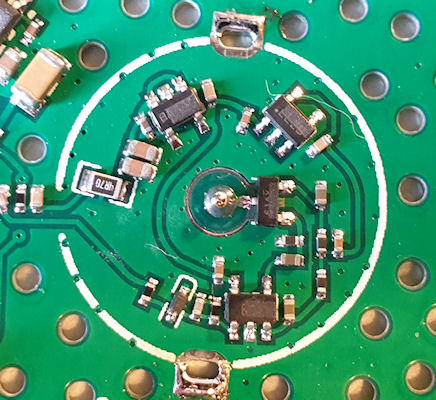

Under the little metal cap on the underside of the chamber there are more discrete electronics and in the center a long gold plated pin that runs into the chamber. All the markings have been removed like the rest of the ICs. It would be very easy to copy this had the part numbers been intact. You could probably make one from a tin of beans, or two. Might not be quite as effective, but I reckon a home made version would be 90% of this bought one.

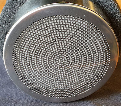

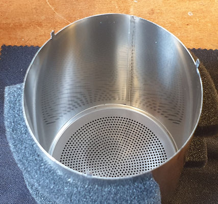

This is the (outer) can of the chamber, and here is where it starts to get interesting.
This is the inner can of the chamber. It looks identical to the outer can, but is covered with a plastic insulation and filter membrane at the top. Inside this (inner) can it looks identical to the outer can, but slightly smaller. I didn't measure it.

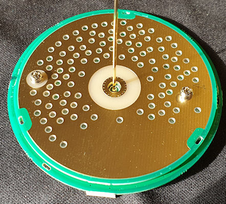

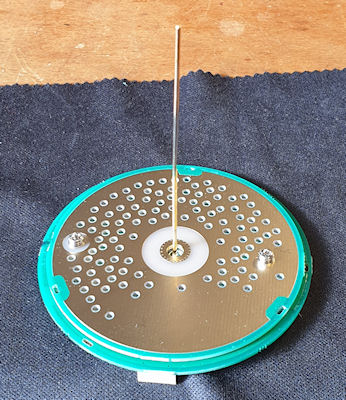

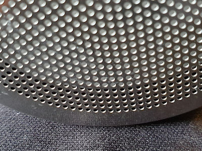

This is the base of the chamber with the long gold plated pin that is connected to the components under the little metal cap on the underside. If you look carefully at the gold plated PCB you can see that one screw is insulated, and the other isn't.
The base is actually two PCBs, sandwiched together with a filter membrane between. The holes in each PCB line up and allow air, or radon to pass through the filter membrane.
And this is where it all comes together. Firstly, I measured the voltage at 300v. Typical voltage for an ion chamber. But even with the tiny components this thing may be able to reach ~700v. I have a couple of counters with tiny HV PSUs like this, and they are quite capable up to around 700v. It may seem surprising, but you can easily get to a few hundred volts using voltage doublers from ~60v or so. Or even a very simple boost circuit, with a handful of components (switching transistor, inductor, capacitor, diode - literally just those 4 components) and run from a PWM signal can also quite easily get to ~700v. I have a counter right here with a PSU like that and I have pushed it to just under 900v, but it gets squiffy >780v.
