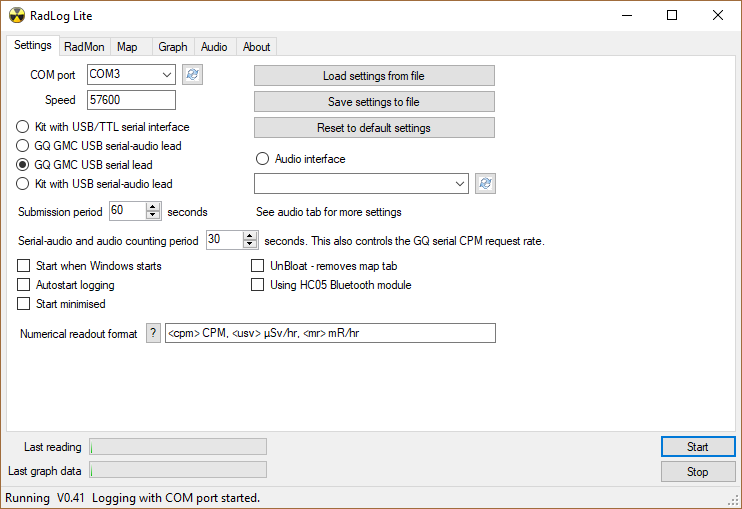

I have a GMC-320 Plus working OK with the GQ GMC Data viewer app, and it uploads data to GMCmap every 5 mins OK.
I'd like to use RadLog instead, but using the settings attached
it does not get any data from the running GMC-320 plus. Anyone running a GMC-320 Plus ver 4 with RadLog on a Windows 10 PC?, that knows what settings should be used?

Does the data view app also show COM3 as the serial port?
Only one application can use a serial port at one time, so RadLog won't work if GMC Dataviewer is running too.
Plenty of people have the GMC320 working, and I'm pretty sure RadLog sets the Speed by itself when you select the GMC serial mode.
Hmmm, I wonder what's wrong?
