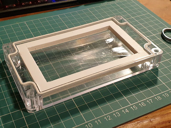

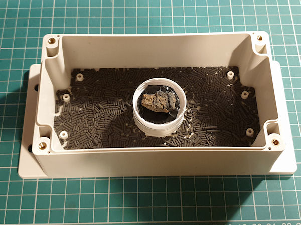

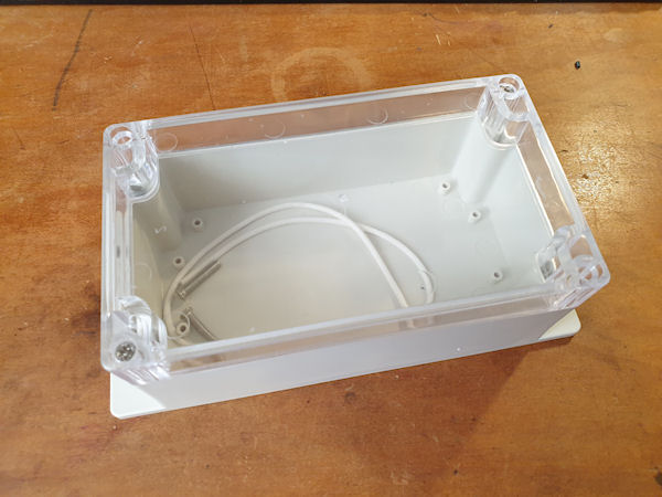

An airtight chamber (electrical project enclosure with a gasket seal) is used to house the Uraninite source, sat on a pedestal, approximately in the centre of the chamber. Above the source a layer of sellotape is suspended with the sticky side facing the source. A single layer of activated carbon pellets cover the floor of the chamber. A Radiacode 101 was initially used for the first spectrum, and then a Radiacode 103 was used for the other spectra. A NetIO-GC10 MK1 with a SBM-20 GM tube was used for detecting soft beta - β⁻. The Radiacode 101 was calibrated prior to the experiment and the Radiacode 103 calibration was confirmed before use.
Enclosure used for the experiment. An electronics project enclosure with gasket for air tight seal.

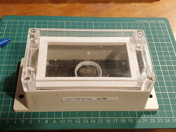

Placement of the Uraninite source and activated carbon pellets along the floor of the chamber.
A layer of sellotape was stuck to a foam board frame and held in place with friction. The sticky side of the sellotape faces the Uraninite source.
The completed enclosure, sealed tight.

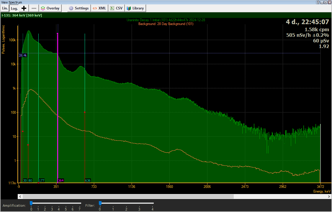

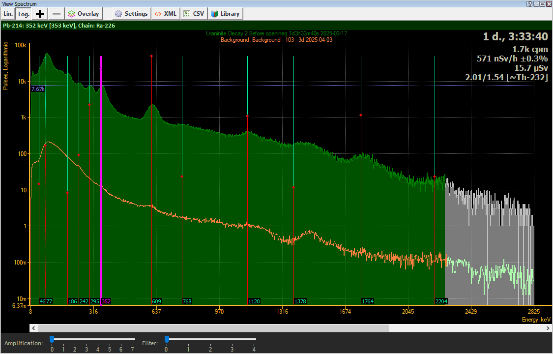

The experiment was put together on 21/12/2025 and an initial Gamma spectrum (4 days 22 hours) was taken with the Radiacode 101 on top of the enclosure, above the Uraninite specimen. After the spectrum was captured it was left for three months for the contamination to occur. After three months another Gamma spectrum was taken using a Radiacode 103 on the outside of the enclosure, in the same manner as the initial spectrum was sampled with the Radiacode 101. These showed Gamma peaks at 354 keV (Pb-214) and 660 keV (Bi-214) and are strong indicators of Radon progeny.
Initial Gamma spectrum with Radiacode 101 sat on top of the enclosure - 4 days 22 hours.
The second Gamma spectrum sampled using the Radiacode 103, again sat on top of the enclosure in the same manner as the first Gamma spectrum - 1 day 3 hours.

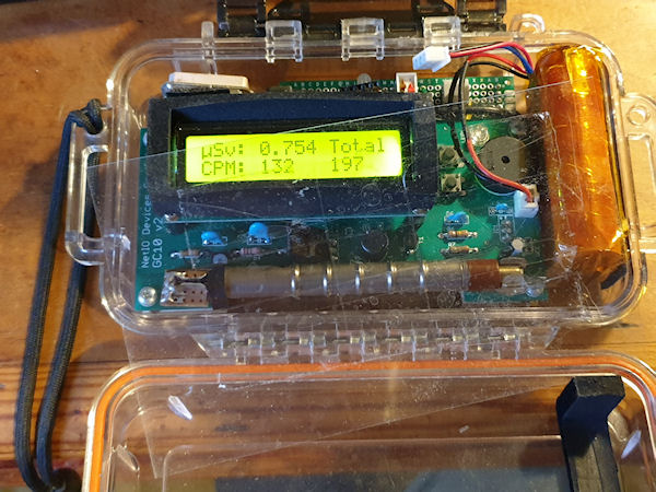

After the 2nd external spectrum was sampled, Gamma spectra was taken of the sellotape and the activated carbon, as well as using a Geiger counter with SBM-20 tube to try to detect Pb-210 (β⁻ 22.3 year half life). The enclosure was opened and the sellotape carefully removed and stuck sticky side down onto a piece of clear acetate. This helps with safety/handling and will stop anything captured from contaminating other things. The enclosure was closed back up with the Uraninite source to contaminate the activated carbon some more whilst testing took place on the sellotape. The sellotape was placed onto the Geiger counter (NetIO-GC10 & SBM-20) and counts of 130cpm were obtained. This indicates the presence of Pb-214 & Bi-214 both of which are beta and gamma emitters and possibly Pb-210 and Bi-210, though their confirmation would require more precise beta energy discrimination. The other isotopes would be much more prominent, so it is impossible to tell at this stage until the other isotopes decay. The Radiacode 103 was then used to sample the sellotape for 3 days. Key findings from the spectrum are: 295 keV and 352 keV peaks indicate Pb-214 is present. 609 keV and 1120 keV peaks suggest Bi-214 is also present. Inconclusive findings of Pb-210. Some counts were obtained at ~46 keV, but not enough to confirm Pb-210. After the three days of Gamma sampling the sellotape was once again placed on the Geiger counter and nothing was detected. There was a negligible increase in counts. This indicates that the initial 130 cpm were in fact Pb-214 and Bi-214 with very short half lives - 26.8 minutes and 19.9 minutes respectively. After several hours some Pb-210 may remain, but in quantity too small for the SBM-20 to detect and the shorter lived isotopes will have decayed away.

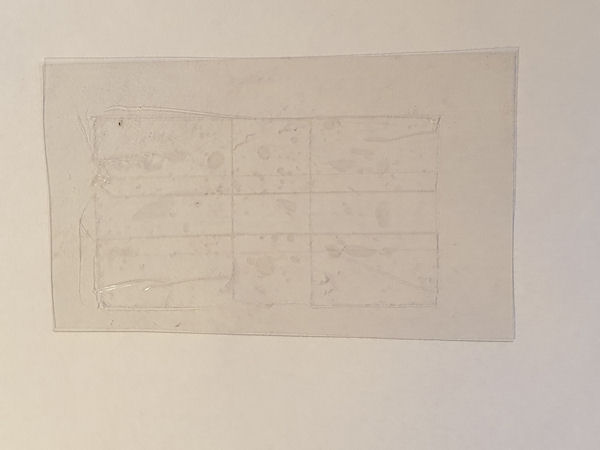

Sellotape stuck to acetate for protection and handling.
Gamma spectrum of the sellotape once stuck down to the acetate sheet - 3 days 1 hour.
Geiger counter with SBM-20 GM tube detecting 130 cpm from the sellotape.

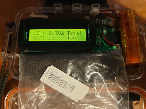

For the final part of the experiment, the enclosure was opened up once more and the Uraninite source removed, along with the pedestal. This made room to place the Radiacode 103 inside the enclosure with the sensor surrounded with the activated carbon. This was left for 3 days an 9 hours to sample for the spectrum. Pb-214 and Bi-214 were detected by the Radiacode 103, as expected, showing that the activated carbon had in fact absorbed the Radon gas and the daughter products formed within the activated carbon. Again, the Radiacode 103 didn't detect any noticeable Pb-210. The activated carbon was then decanted into a sealable plastic bag and placed onto the Geiger counter with SBM-20 tube. Counts of ~53 cpm (background = ~24 cpm) were obtained from the activated carbon. A MiniMonitor 5.10 Geiger counter with a Mullard MX-123 GM tube was used to sample the activated carbon with no noticeable detections being shown. The MX-123 GM tube is capable of detecting hard Beta (β⁺) and Alpha (α) radiation, but soft beta (like from Pb-210) is typically below its effective threshold. The SBM-20 GM tube is capable of detecting Gamma (γ) and hard and soft Beta (β⁺ / β⁻), and knowing the decay chain for U-238, and is still detectable several days later, this would confirm the presence of Pb-210, with a half life of ~22.3 years.
Activated carbon on the Geiger counter showing ~53 cpm some hours later

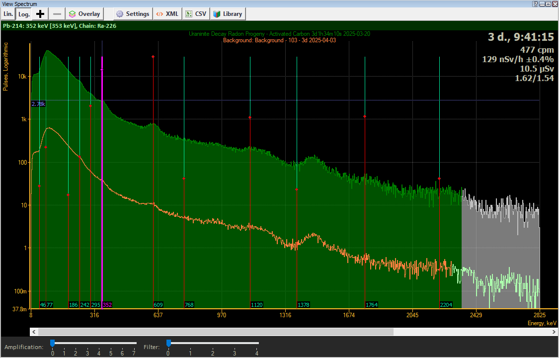

Gamma spectrum of the activated carbon - 3 days 9 hours.

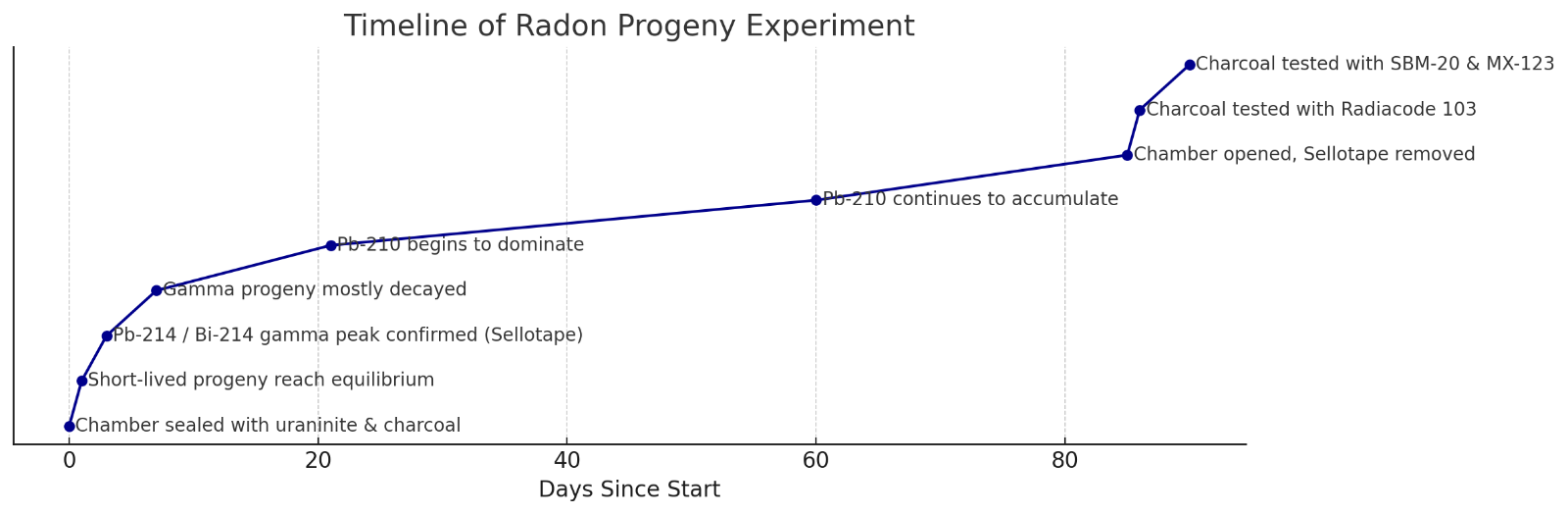

Experiment time line.

- The activated carbon, after 3 days and 9 hours of gamma collection with the Radiacode 103, showed distinct Pb-214 and Bi-214 gamma peaks.
- Charcoal placed in a plastic bag caused SBM-20 counts to rise from ~24 to ~53 CPM, suggesting retention of low-energy beta emitters.
