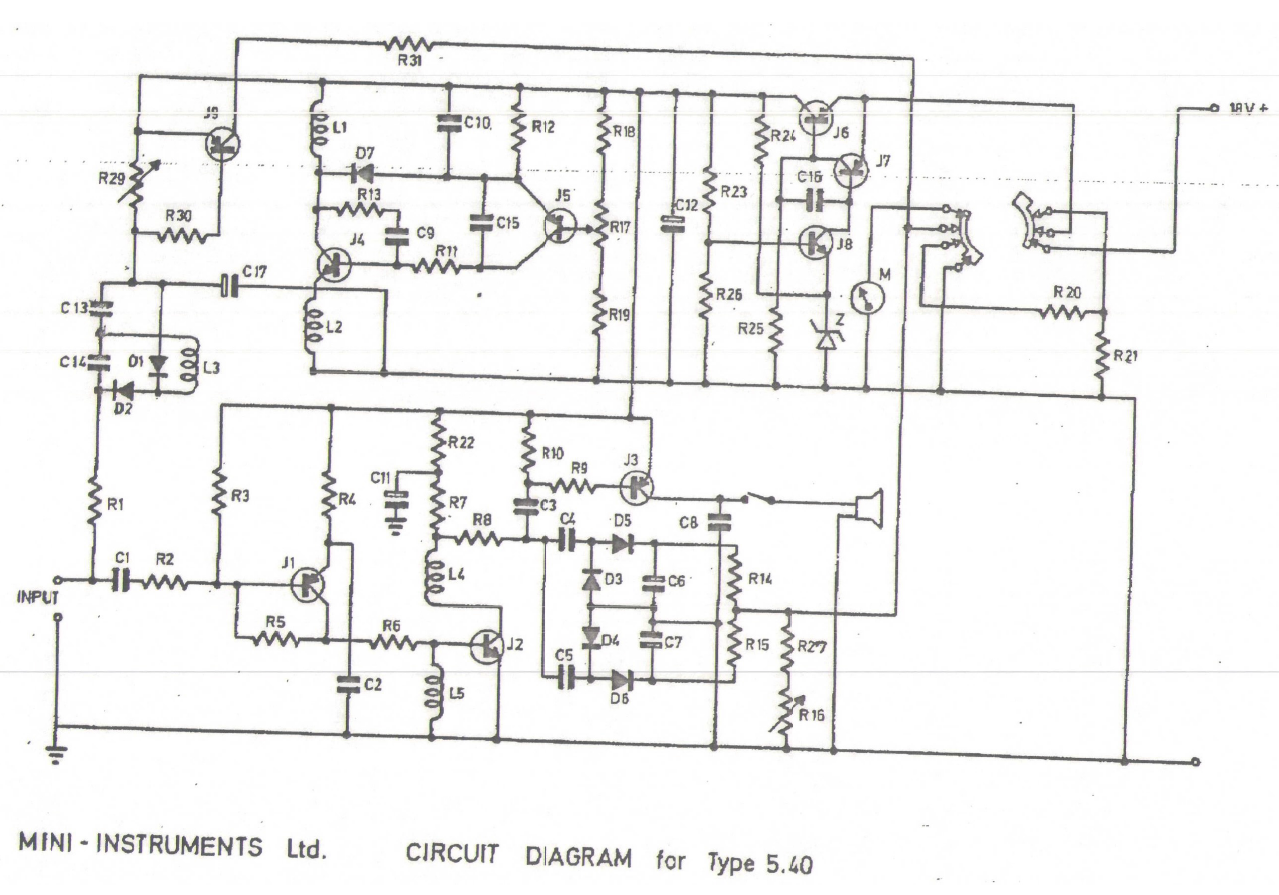

After a quick look over the circuit and reading the circuit description I reckon I could tap off somewhere right after J1 and use (make) a small amp circuit to the PC sound card input. Time to get the scope out and have a look at it in operation. This really is the info I have been looking for. If I manage to get it all working as a spectrometer I will most certainly write a small 'how to' for other's to follow. It's one thing being able to detect radionuclides but a completely different animal being able to differentiate between radionuclides.

I have had a bit of a probe about with a scope on this and I'm 95% certain what I want to achieve can be done. I'm reckoning to tap off right between C1 and R2 where they connect and make a small inverting amp circuit to connect to the PC soundcard. I have also been doing more research and the Theremino MCA software comes with a lot of documentation and is suggested the signal needs to be conditioned also. Mostly in the form of filters.
So next stage is to build a little amp circuit and test, then look at filtering. Then all being well it should just be a matter of learning the software and making sure all the settings are good for sampling from the scintillator. More to come soon!
