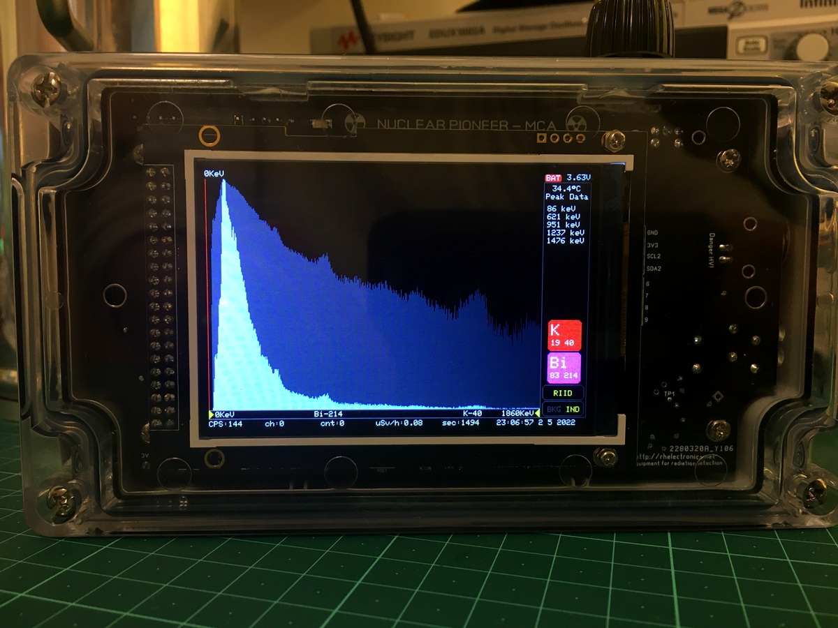

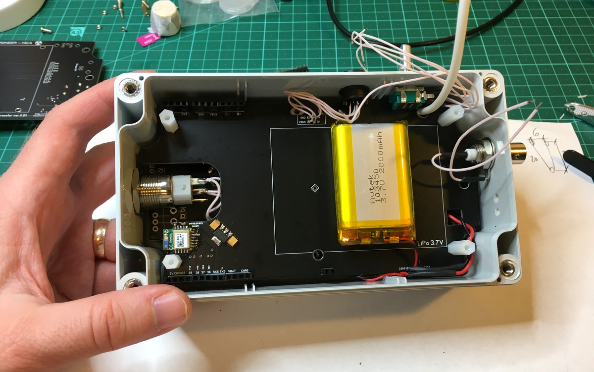

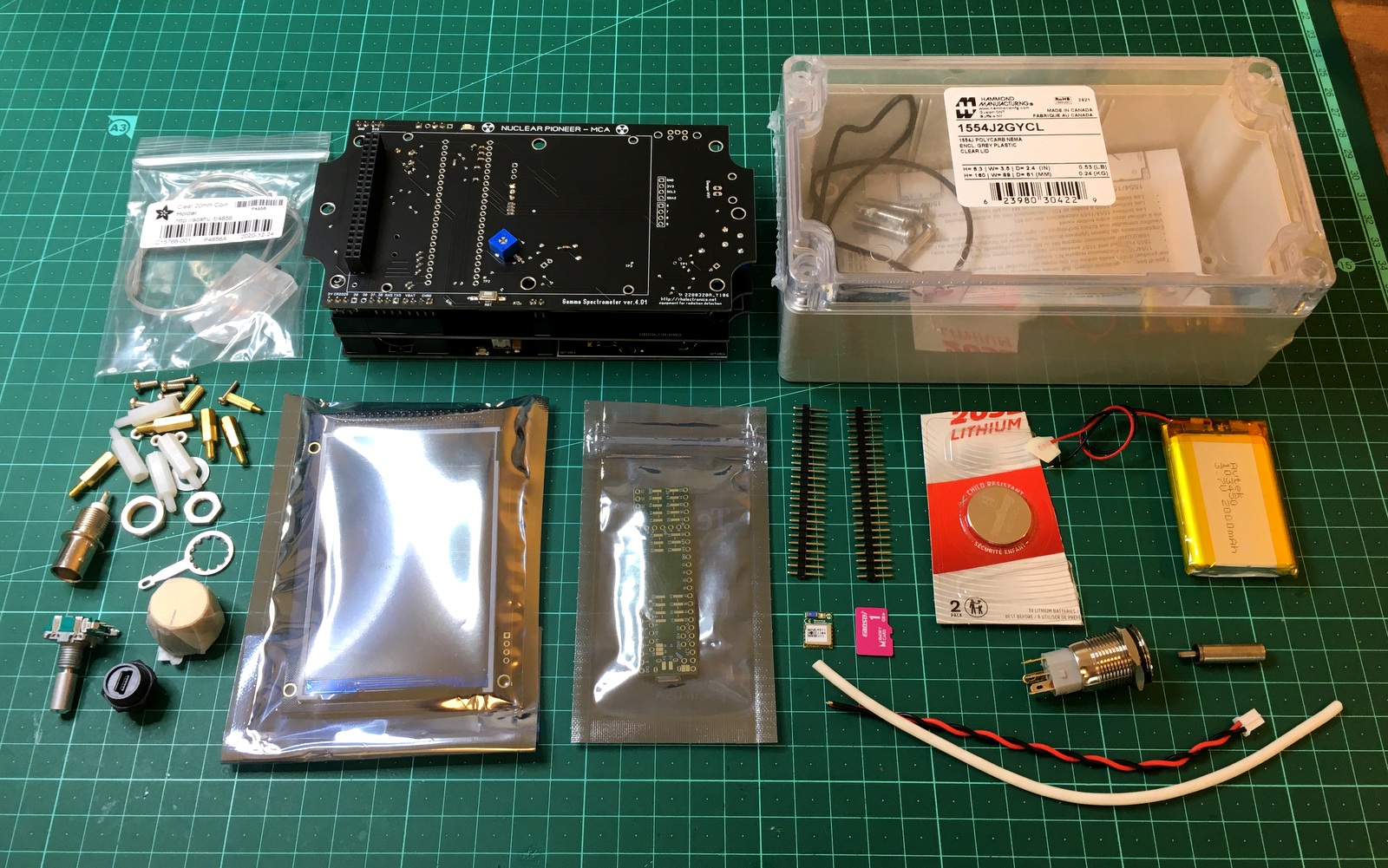

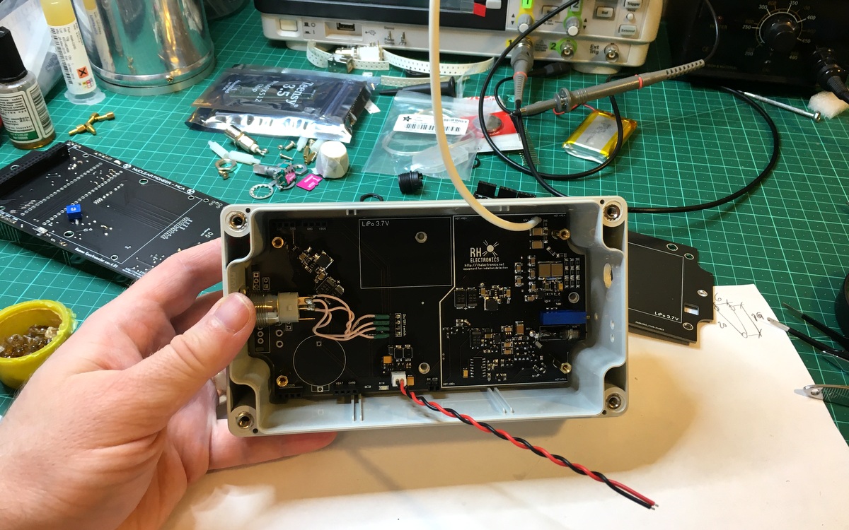

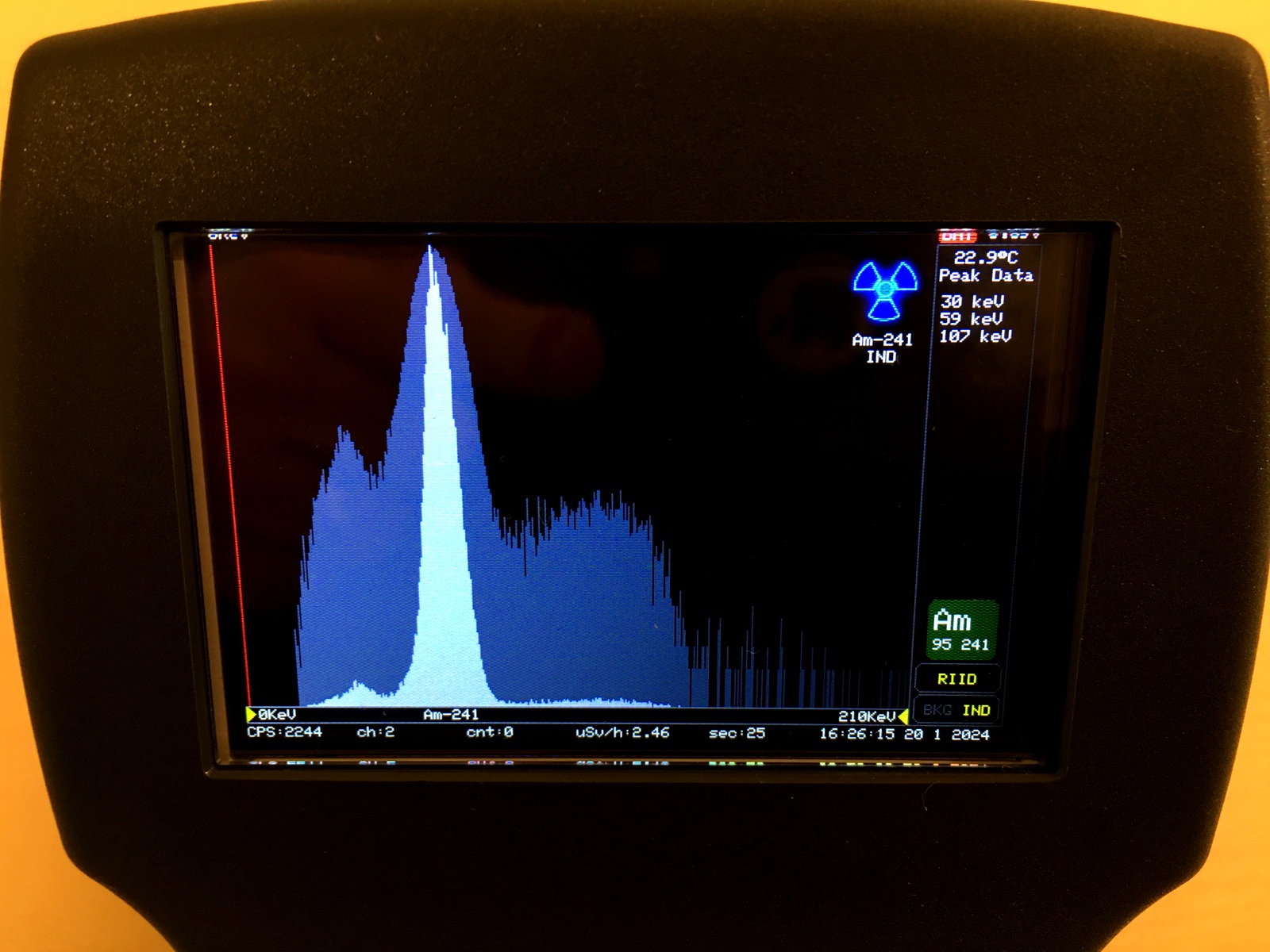

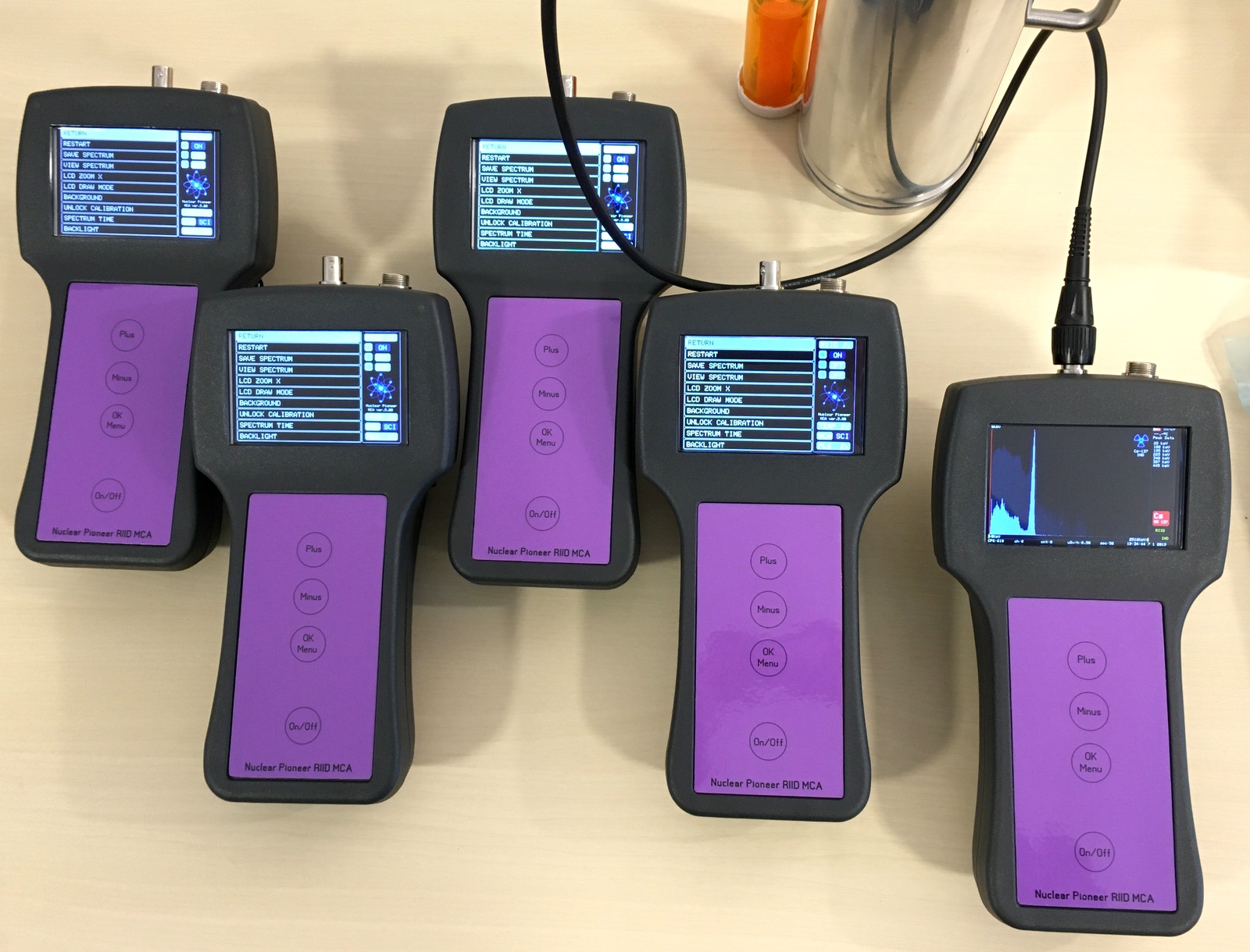

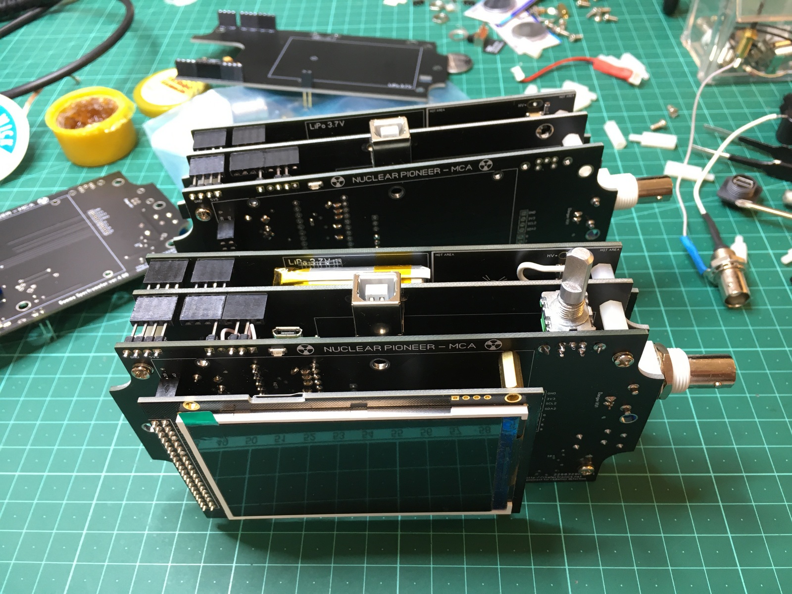

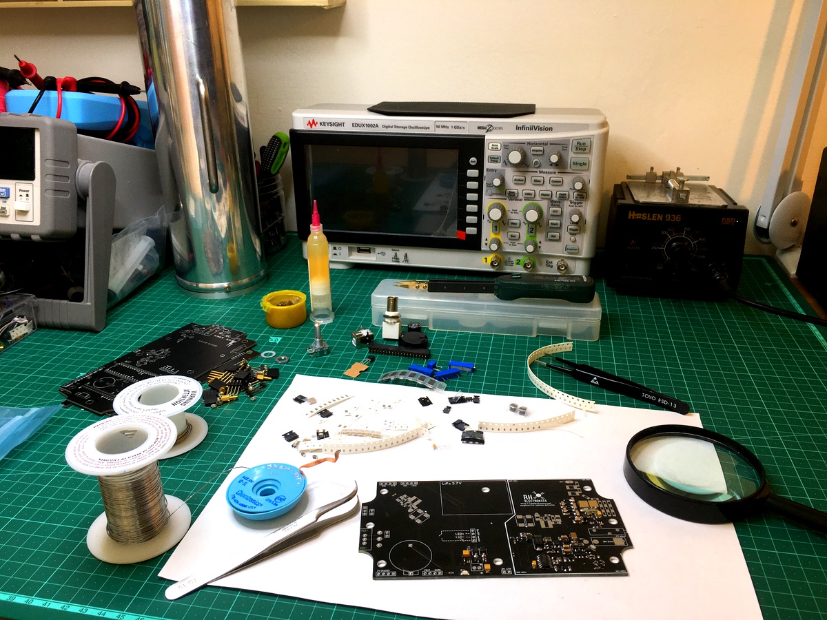

Few photos from the process of the Nuclear Pioneer modules soldering, testing, calibration and assembling into Hammond enclosure.
RIID brief test:
I have the promo code for ordering Nuclear Pioneer $50 OFF: SPECIAL50
valid for the website https://rhelectronics.store
RIID brief test:
