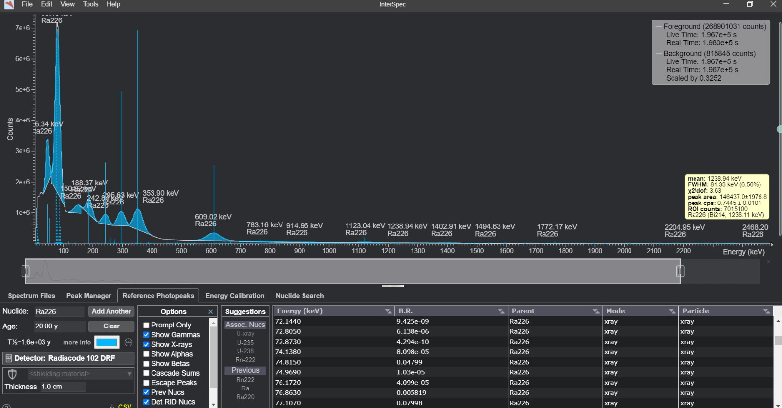

269 million counts lol! BecqMoni lost connection to the counter after 3 days, I think it was my fault because I tried to connect using my phone just to monitor what was happening remotely and that caused a hiccup. Also, if the iOS app is opened and connected unless you force close the app it hangs on to the BT connection and prevents anything else connecting to the RC103. Took me a while to figure out why I could not connect again using BecqMoni (dumb mistake on my part). Anyway, I don't think a higher count would have provided significantly more info. InterSpec found a lot of peaks and I got it to fit those peaks to known nucleids which gave me a correction offset. I always suspected it was reading energy levels a bit low - and it was. I got BecqMoni to write new calibration data to the RC103 but it still needs checking regularly. Best FWHH I see is around 9% which is maybe a little higher than advertised.
Next job is to take a detailed spectrum of Thorium and see if the energy calibration provides better accuracy than it did last time,
