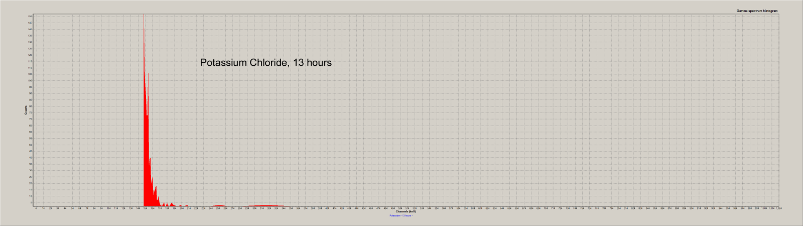

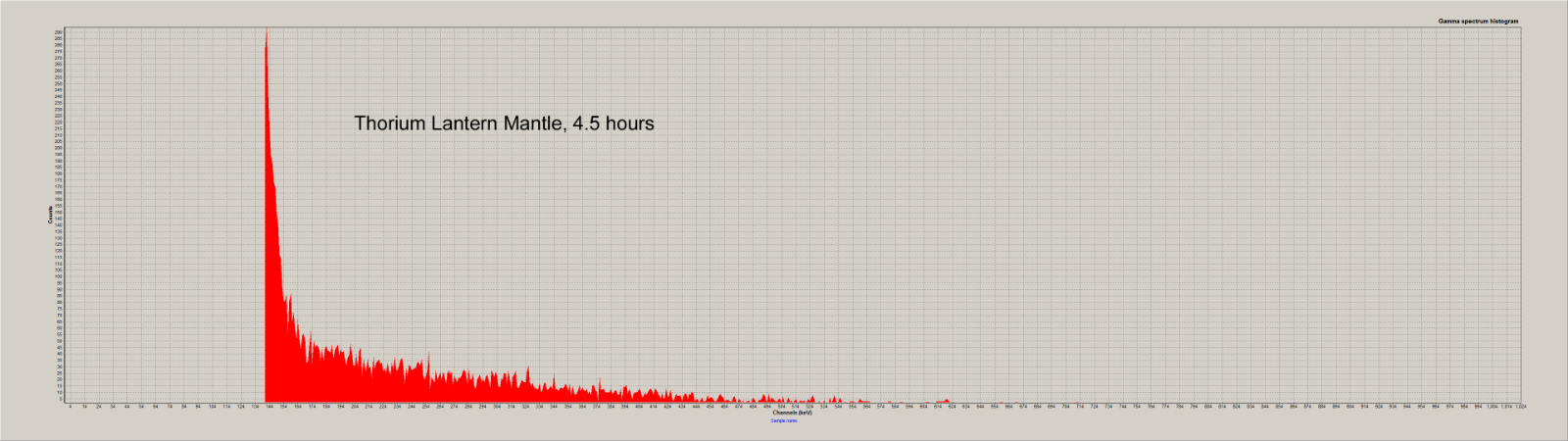

6 years 11 months ago - 6 years 11 months ago #4779
by GetSirius
Mineral Point radiation/lightning monitor: getsirius.com/radiation
Replied by GetSirius on topic Geiger Counter + Gamma spectrum analyzer under 10€
I found this on DExUS' website, then found it here. Thank you DExUS.
Built the circuit a few days ago and tested today. Seems to be doing some kind of signal level recording. I know little about this! I assume the numbers given for Channels are just that, channels showing the audio level of each hit, not actual keV. The numbers change when different Channel is selected (512, 1024). Not sure DExUS visits this website since the last log in was years ago, anyone have some guidance as to what I am seeing? The images are data from a thorium lantern mantle recorded 4 hours, 27 minutes. Also potassium Chloride recorded for 13 hours.
Perhaps I need to test a few items that I can find spectrum graphs for, then compare to my graph so I can guess keV numbers.
Last edit: 6 years 11 months ago by GetSirius. Reason: Add images
