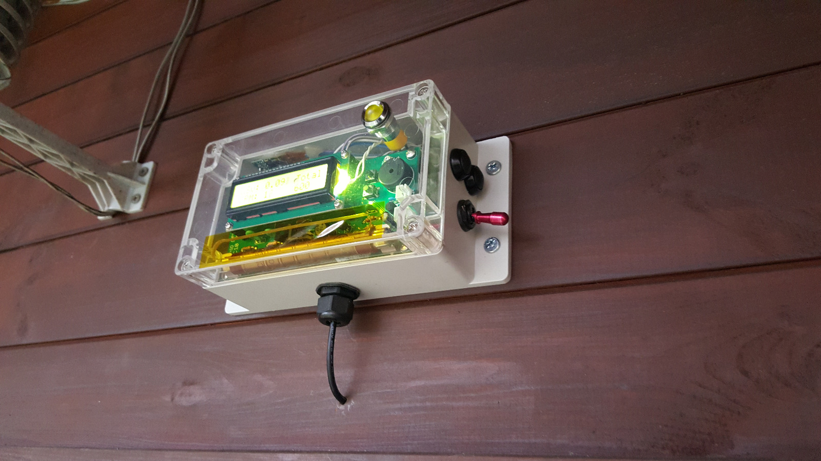

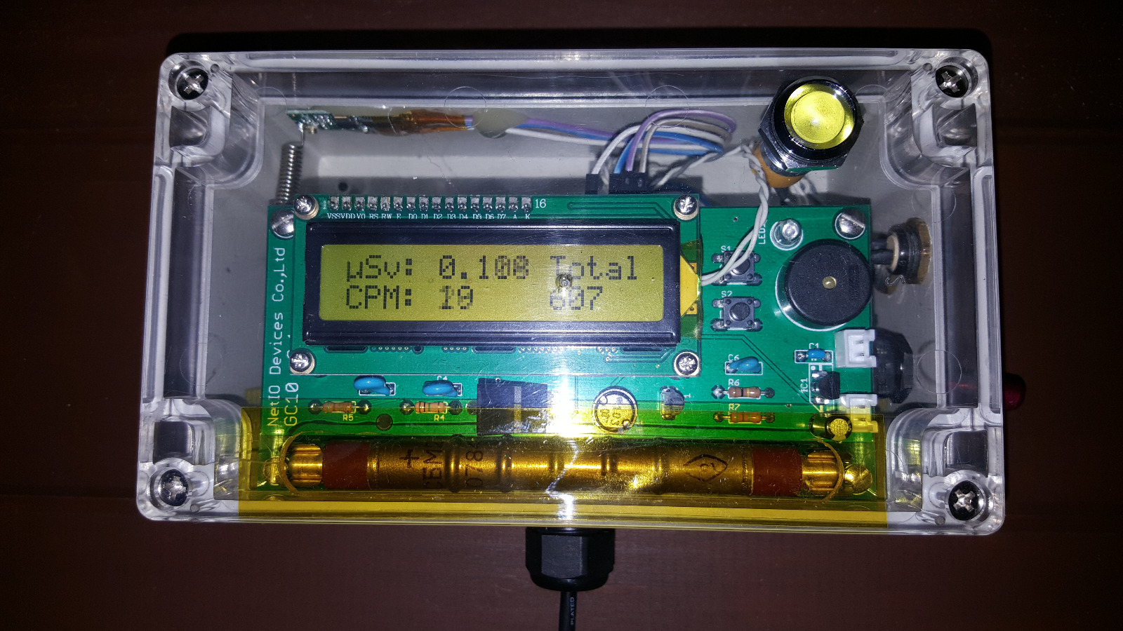

I mounted my counter in an ABS enclosure outside under a canopy on my workshop. I cut a slot in the front where the tube is and covered that with Kapton tape to keep it reasonably air tight. I have seen people use PVC pipe for housing their tubes. I used some 20mm plastic (PVC?) electrical conduit to make a house for a SBM-20 tube that I can fix externally to a window on my car with a sucker. It works fine but it is ever so slightly less sensitive. For background monitoring though I think this would be fine. As you mention, use something with as thin a wall as possible and also keep it watertight if used outside. Airtight would be better but it is hard to achieve whilst maintaining accessibility for service etc. I have a couple of large bags of desiccant behind the board in my counter that I have replaced once in 3 years and has done a fine job of keeping it dry and corrosion free. I live by the sea so we have quite humid air at most times.
When it comes to detection and detecting alpha/beta/gamma it depends how far down the rabbit hole you want to go. The SBM-20 tube is capable of detecting gamma and hard beta OK. It however, will not detect alpha at all. For that you will need a tube such as the LND712 (great for portable hand held counters) or something like the SBT-10A (very sensitive to alpha, beta & gamma - great for surveying). The issue with detecting alpha outdoors is that the tube itself would need to be open to the elements. Over time the tube window would need cleaning which in most cases would ruin the tube itself as you are not supposed to touch the alpha window at all. I have a SBT-10A that mysteriously destroyed itself but does show how fragile they are. I believe it is possible by using mica to create a window for the tube as that apparently lets alpha pass through but I have never experimented with so can't say for sure although a lot of alpha tubes use mica themselves. It is possible to detect beta and gamma using SBM-20 tubes but this requires two tubes, one shielded with 3-4mm of aluminium and the necessary counting electronics. Basically two separate Geiger counters, one with the shielded tube. The unshielded tube will detect gamma and beta whereas the shielded tube will detect gamma only thus if there is a noticeable difference in counts, math can be applied and the difference in counts would be the beta detection.
Going back to your SBM-20 housed outdoors there are some things to be aware of. Make sure the cable between the tube and the counter is no more than about 1m in length. If you are going to mount the tube separate to the counter it would be prudent to place the anode resistor at the tube itself and not at the counter. This will reduce interference causing inaccurate readings. I like to keep my tube as close to the counter as possible which rules out any interference a cable may pick up. It would be perfectly fine to place the counter on the inside of a wall and the tube directly outside using a small cable (20cm or so). I would still put the anode resistor at the tube though. But in doing that you will have two things to house and mount so putting the tube in a larger enclosure with the tube may mean a lot less work.

My background monitor at home (mounted outside under a canopy on my workshop)
