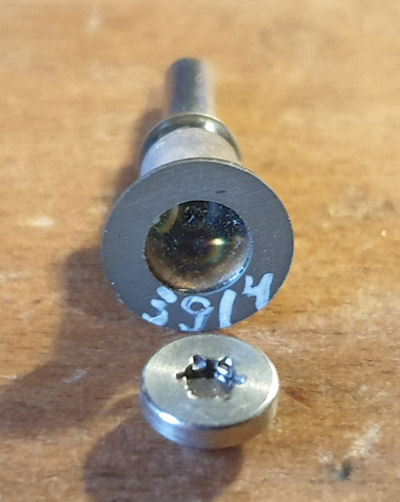

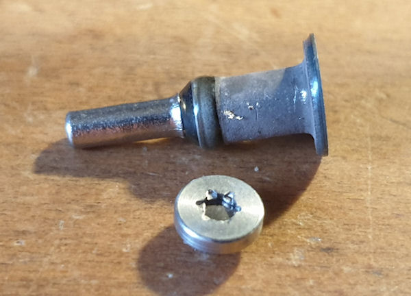

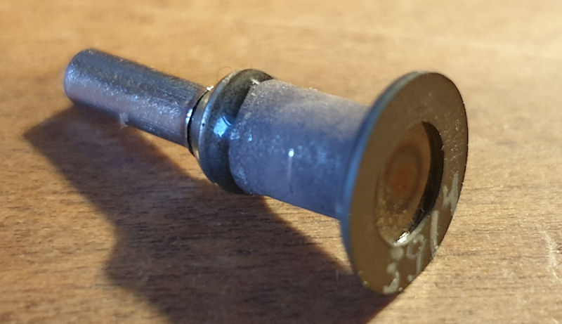

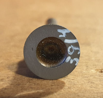

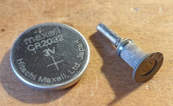

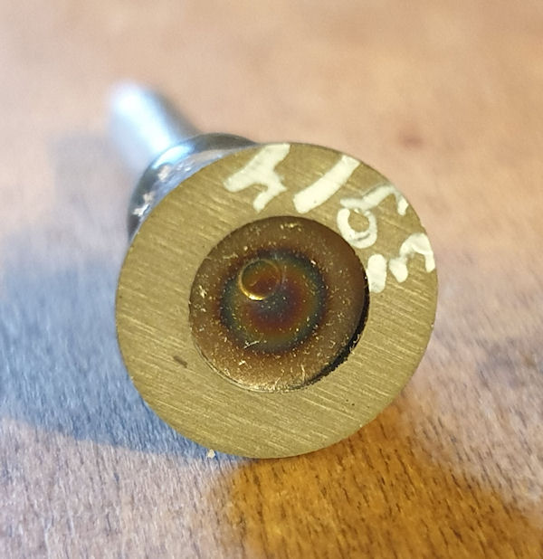

I received this today after waiting for it to arrive for a couple of weeks. Purchased from Ukraine (via ebay). Not only is it tiny, it is the most expensive GM tube I have bought yet per gram of weight! And it appears to work okay. Sensitive to Gamma and Beta. This tube really is remarkably small. The end window must be no larger than 6mm diameter and the whole thing is only 20mm in length. It's not sensitive and for the couple of minutes I had it on test, the background was about 4cpm and it went nuts with Am-241 being held close to the window.
The specifications are a bit sketchy and I can't find a datasheet with the proper specs. These are from the ebay listing:
You can download hi-res pictures here.
The next images show it next to a CR2032 battery and an Am-241 button.
- SI-19BGM geiger tube is designed to detect betta, gamma
- Sensitivity Radiation 1000-1500 Pulses/s/R/h
- Plateau Inclination 0.25%/V
- Working Voltage 360-440V
- Maximum registering range 900 Roentgen/hour
- Length 20mm
- Diameter 9.3mm
- Weight 4 grams
