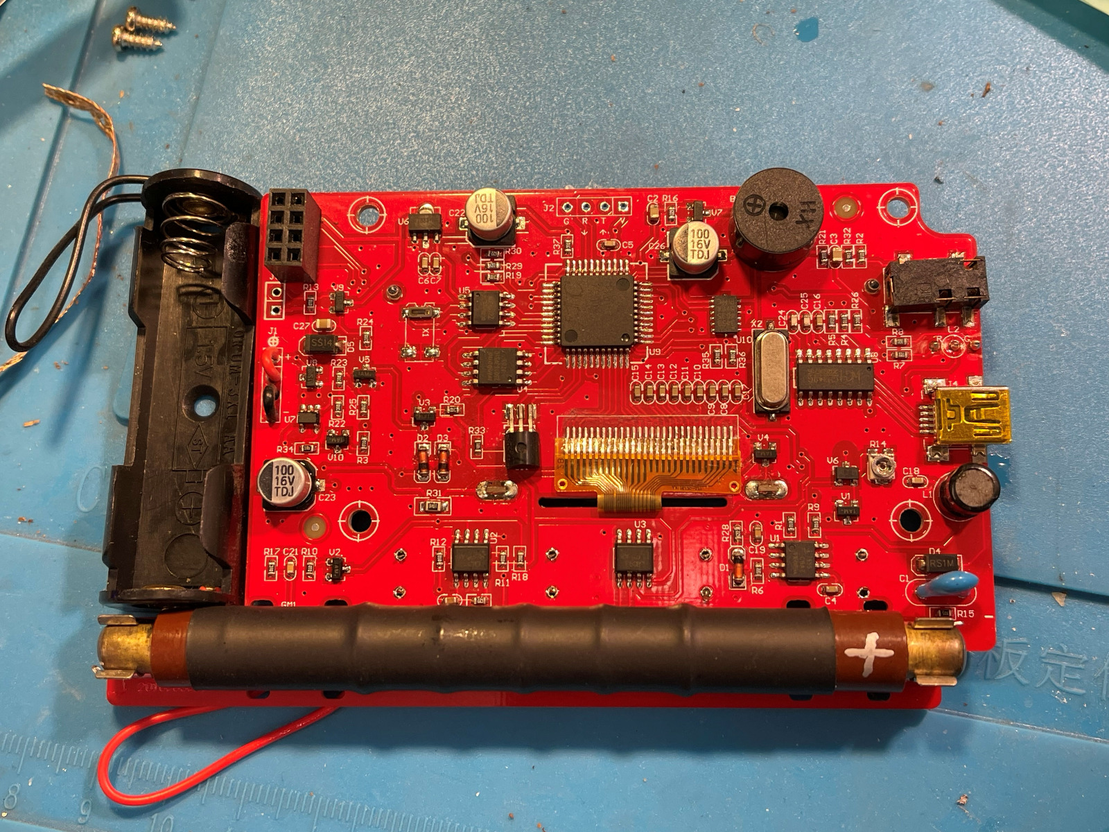

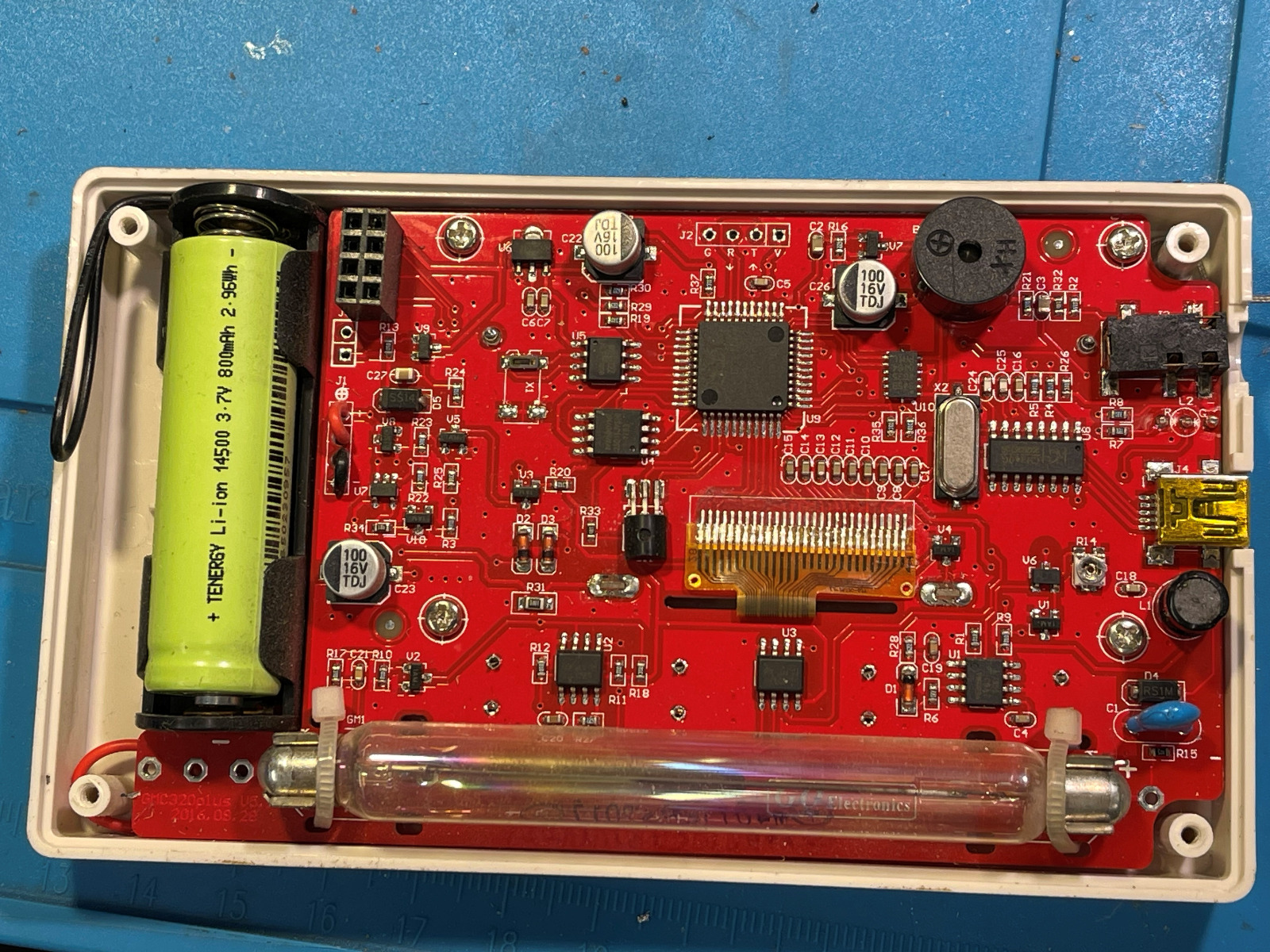

1 year 5 months ago #7294
Replied by ChrisLX200 on topic Glass Tube Shootout
Swapped out the 2017 vintage 4011 tube (which was UV-sensitive) in my GMC-300E+ for an SBM-20. Edited the calibration settings to match. It really didn't want to start after the change and I was thinking it was broken but it was fine after I plugged the charging cable in. Think the battery was just too low.
