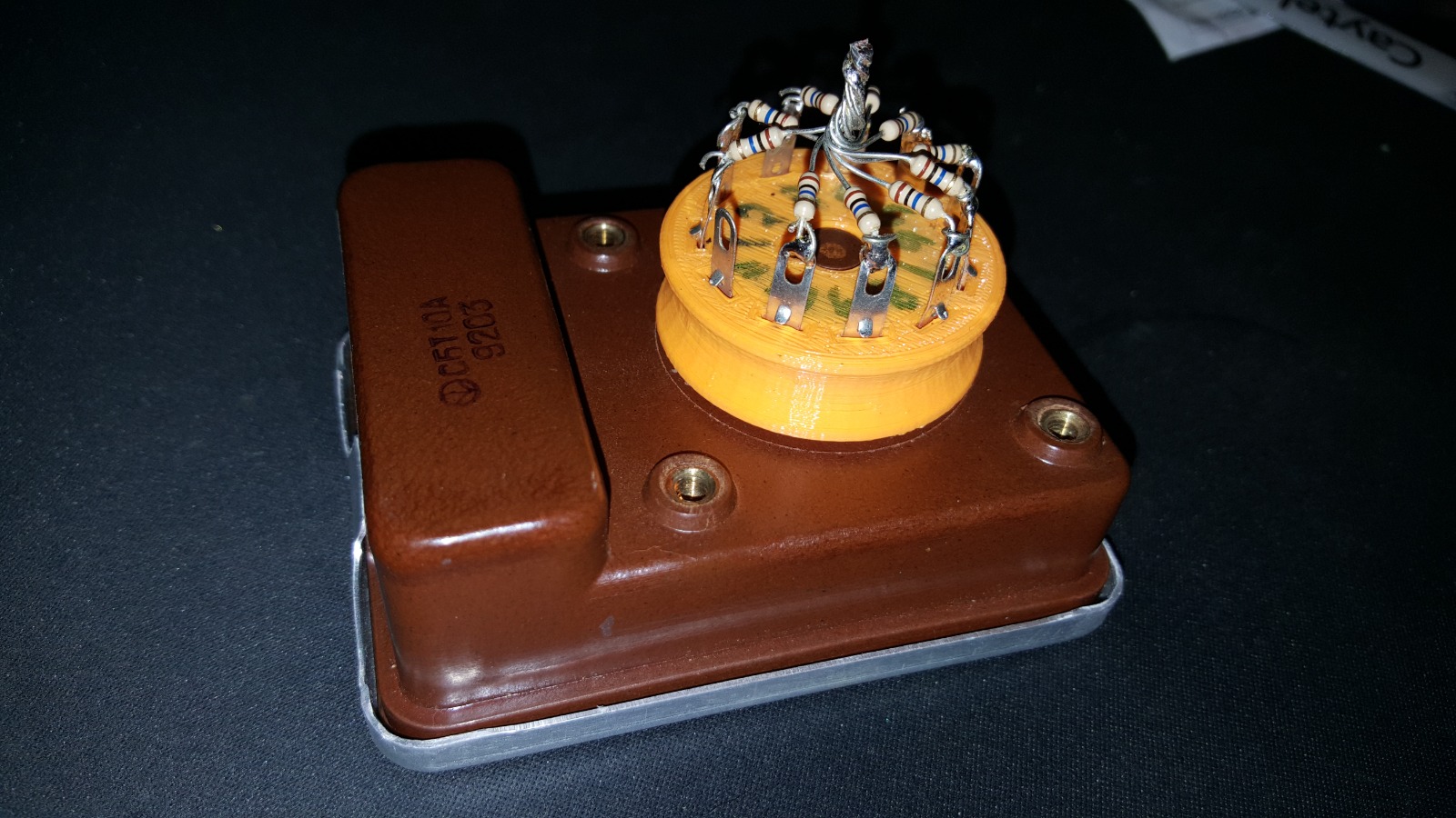

so recently I've been having issues with one of my Geiger kits I thought the kit was messing up but after viewing my SBT - 10 tube in the dark I realized it was an avalanche issue on one or two of the sections of the sensor tube. I am currently using just one dropping resistor for the whole tube would it make any difference with the Avalanche problem if I were to use a dropping resistor for each section of the tube. Does anyone have any input on this or ideas on resolving my Avalanche problem? Does this possibly mean I just have a bad tube?

I would try using a seperate resistor for each section of the tube. I have mine with a 10Mohm on each section (see pic below) and appears to work OK, though I haven't had it running for long and just some simple tests. When I got mine I scoured the web looking for info but it seems there is very little. One recurring theme was that the voltage and resistor(s) did play a very big part on getting correct counts from the tube.

You could try changing the resistor(s) for a higher value as per the text above. What I have found, accidentally, was that if I connect another 10Mohm resistor in series with the tubes my CPM increases a little for each of my check sources.

just like you I have found very little information online regarding this tube at least compared to information available on all of the other Geiger tubes that I have purchased. I had to order some higher-value resistors but in the meantime I added a 1 Meg resistor to each section of the tube in series with the 4.7 Meg in the kit and so far I have not had an avalanche problem again.
