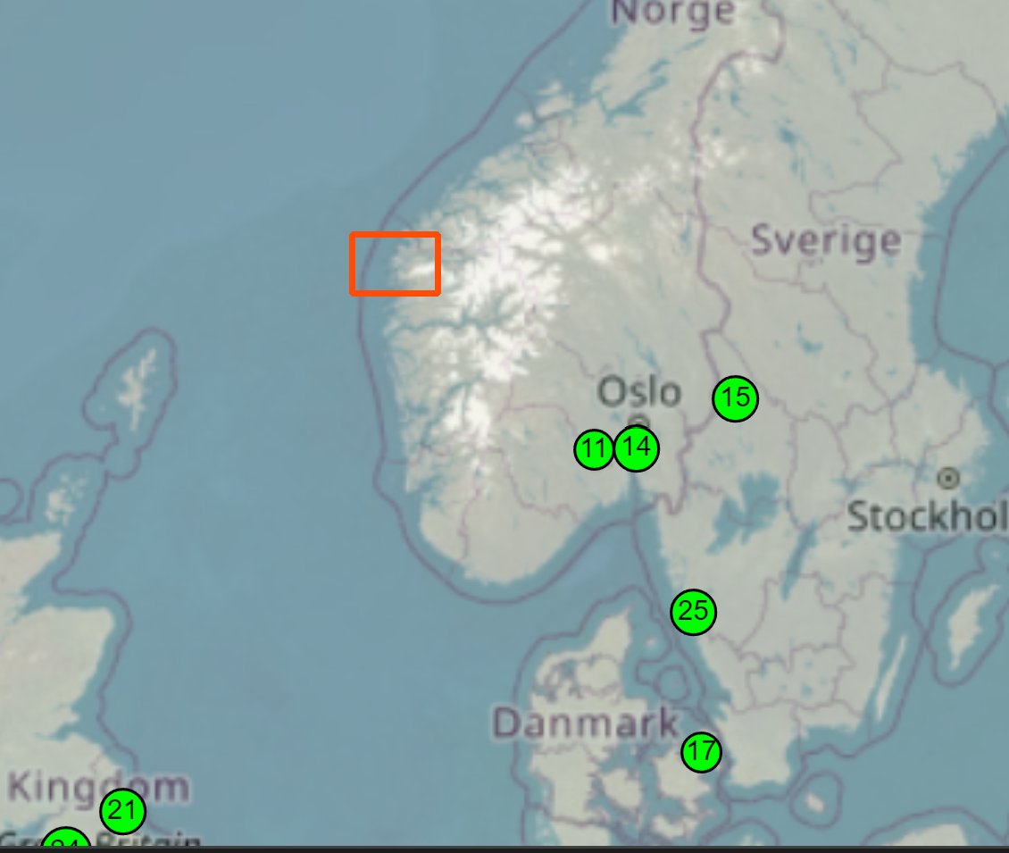

Hello. I have been at radioactive@home for a few years.
Running kit v 2.61 with USB connected to a WIN10 computer,
with the Boinc Manager software to upload to radioactive@home server.
As You probably know, the radioactive@home servers are repeatly down again,
and I would like to get my kit running on the web.
Has anyone a way to get this kit working with Radmon ?
As I can see there are none detectors at my position in Norway.
Regards,
A.Aamot
Floroe, Norway
