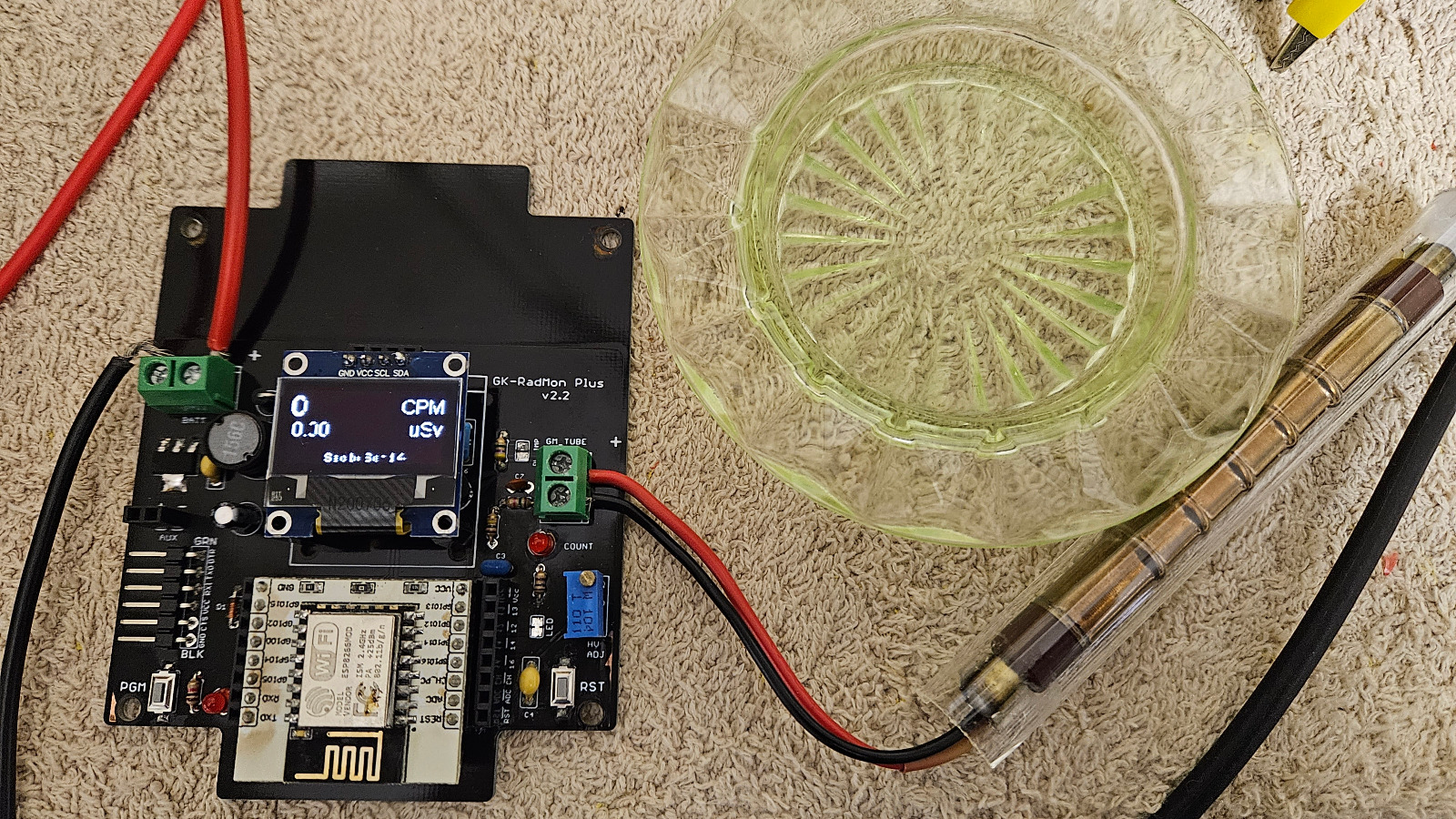

My radmon plus has been outdoors for about 2 years and recently water has entered the enclosure and got on the electronics.The esp8266 appears to be transmitting data to radmon.org so that all looks OK, but the high voltage supply doesn't seem to be working. The OLED display appears to be displaying the correct HT voltage, but when I measure it using the resistor string with my multimeter it reads about 7 volts, touching the probe on the terminals while making measurements will also make it give a false reading of a high number of counts.That means I'm probably getting around 70 volts? Looking at the schematic, the unit is supposed to be sending 3.5khz pulses from the arduino GPIO pin 5?Nothing appears to be showing on my oscilloscope that I can tell when probing that pin.Any ideas on what else to measure?
When i touch the negative pin of the GM tube terminals, it causes the unit to register a reading.
Ive gone over the solder joints and given the whole board an ultrasonic clean to get rid of corrosion, etc. And lastly,  is there any better quality enclosure with a window? The one I bought with the clear window went all crazed and yellow on the lid and started to break down from the sun's UV.Have added photo of board running. Screen has suffered a bit of damage but still readable.

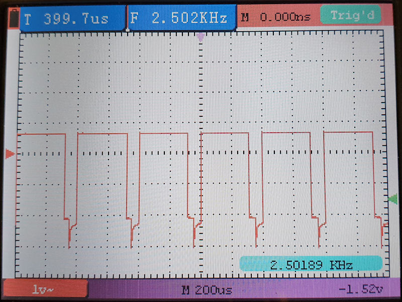

I also checked the PWM on mine with a scope and the trace is below. I connected my scope to the female pin header next to the ESP pin headers, so is coming right from the ESP and nowhere else on the board. If I was testing the ESP I would remove it from the counter and power up on an external 3.3v supply and write a very basic code to simply test the output on GPIO5. Maybe test for high and low outputs, then test for PWM. If it has failed on GPIO5 it may be possible to use another GPIO instead of GPIO5, but that would require some modification to the circuit.

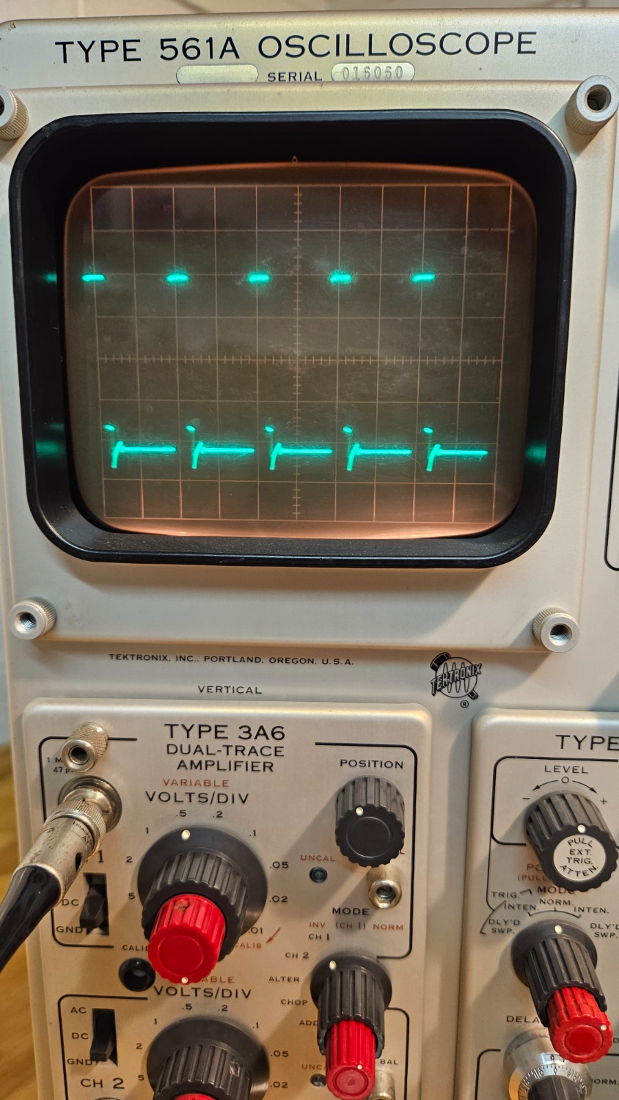

here is a photo of my scope output on GPIO5 while counting, looks like this is OK?
What should i be testing on the board if im getting no HT?
I see some sort of signal on one of the pins of Q1, just needing to work my way between GPIO5 and the HT.
