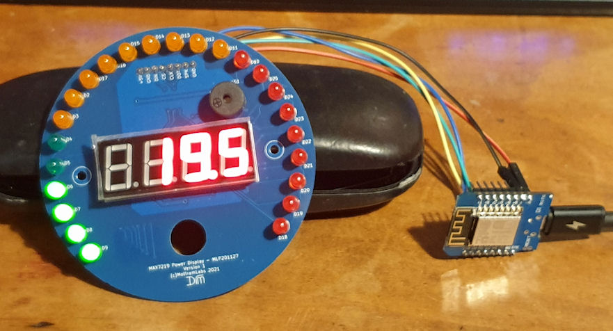

Its the first day of holidays and I'm bored already.... So I cooked up a neat wifi/wemos d1 mini/arduino/LED display for displaying a station's current CPM.
It works by simply connecting to one's wifi and then goes to the URL, pulls the data, strips the first space and everything afterwards then converts what is left to a float (the CPM count from the start of the string) and displays it. The bar graph LEDs are mapped from 0 to 100 CPM at full scale deflection, but the 7 segment display will display up to 999.9 CPM, and after that will just display - - - - lol. It's super easy to build (5 wires and no more!) and cost about a tenner (Ten Great Britain Pounds Sterling) in all. The display is actually for another project, but I'm waiting on parts for that so thought I would learn how the display works and made this! I think I'll keep it and house it in something nice. Maybe a vintage round desk clock case or something. I am struggling with the speaker on the display and it just sounds like crap when I try to use it. It may only be compatible with an arduino, not the wemos d1 mini. The pictures are less than desirable, but meh.... You get the idea!
I have added a feature to display in uSv/hr instead of CPM - Selectable in code.
I wrote a very simple PHP page that generates a random number between 10 and 100 for testing purposes. It emulates the 'last reading' page from Radmon.org so can be used in testing playing with the string also. (For parsing etc.) You can use it here: http://wasabi.schmoozie.co.uk/radmon/random_cpm.php and source below.
The display module is from www.mottramlabs.com (shop on ebay) and the MCU is just a Wemos D1 Mini R2.

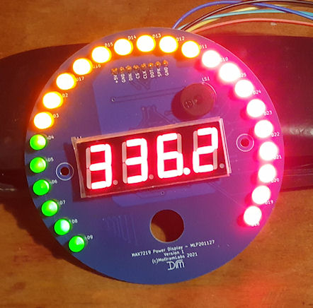

This is reading 336.2 CPM (fudged, so it will show the full bar)
