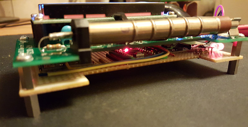

Hi all!
I recently bought myself a DP-66M from ebay, then another one, then a NetIO GC-10 and I have another on the way. Maybe a different one soon? It's fair to say I have been bitten by the Geiger counter bug!
I am building a static outdoor monitoring station at home, monitoring 24/7, but currently waiting on parts from China. In the meantime I have been playing with the GC-10 and built a prototype mobile GPS logging unit to take on my travels. I live not too far from Heysham power station and the Westinghouse Springfields nuclear fuel manufacturing site, so I will be having a drive around them soon to see if there are any elevated levels

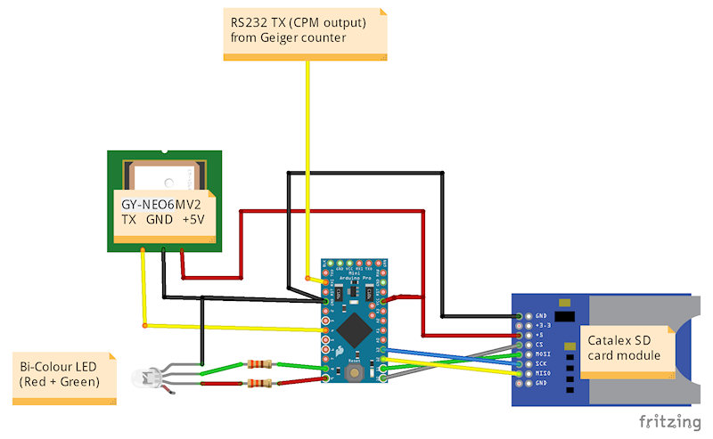

The unit uses an Arduino Pro-mini at the core, with a GY-GPS6MV2 GPS receiver module and a Catalex SD card module. All are cheap as chips on ebay from China. The Arduino takes the GPS data via RS232, the CPM from the GC-10 RS232, does a little processing and parsing of the data and shoves it on the SD card in a CSV. Each time the logging is started it creates a new filename generated from the date/time so should be easy to get the data and upload it to Google maps or something similar (I haven't gotten round to that part yet). There is a bi-coloured LED that changes from red to green when a good satellite lock is acheived and it will not start to log the data on the card until a valid date/time is received from GPS. This keeps the CSV files nice and tidy with proper logs only.
In testing I have had issues with the batteries (2x AA via a 5v boost converter to the GC-10), but I think that was down to bad batteries, so I am currently testing on fresh batteries. I checked the current and it is pulling just under 4mA at the batteries, so whilst they won't last long, it should be enough for some walky-walky monitoring. I plan to add an external GPS antenna/socket and maybe a couple of 18650 Lipo batteries and charger/protection circuit/module. I think it would be nice to be able to power from either the car 12v or maybe a 5v USB type power input that would charge the batteries when plugged in, but that is for another day.
I tried uploading the zip file containing the source/schematic etc here, but it failed. Probably due to the zip size (12Mb) so I have uploaded it to my server for you to download here: GPS Geiger Counter
Contained in the zip are some photos of my prototype build, the Arduino source and schematic so anyone that wants can go build one also! Some knowledge of electronics/arduino will probably be needed as I have not, nor intend on doing a step-by-step.

Well done! Looks great, love the homebrew board on the bottom,
Thank you for sharing!

I should note though that my project is only the homebrew board. It is designed to connect up to any counter that gives CPM via RS232 and gives that counter logging and GPS capability so in theory it should be compatible with any counter that gives CPM via RS232.

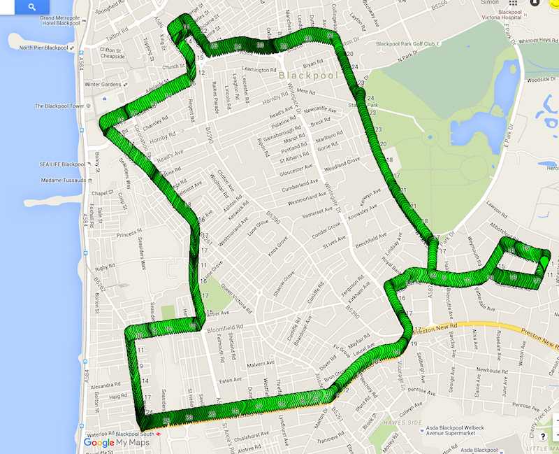

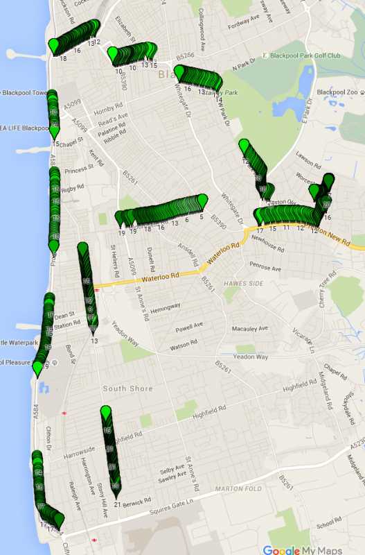

I went out for a quick test with it and it seems to be OK except for sketchy GPS data. I think I need to improve the GPS antenna, so adding an external antenna should sort that. I have a Peugeot car with heat reflective windscreen and it plays havok with most cheaper GPS receivers. At least I'm hoping that is the issue!
Here is the data for anyone interested and a quick picture of what it looks like so far:
https://www.google.com/maps/d/viewer?mid=zasLAdbQXqtw.kxVyakPPw-s0
Cheers!

After some more testing and investigation I found the issue in sketchy GPS was actually the code. I've fixed it and the results are much, much better. There is just one tiny issue now where the CPM being read from the counter is recorded occasionally with an extra digit or two counts on one record. I reckon once that is sorted I can call it version 1.0
I have updated the download link with the latest code. Here are the results so far:
https://www.google.com/maps/d/edit?mid=zasLAdbQXqtw.kInoUYbBsJO8&usp=sharing

Looks great! Working well.
