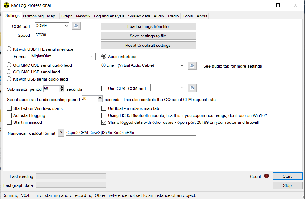

Well,,,,it WAS working fine until Mr Windows did an update. Now the program will not see the input from the virtual audio line. See the message at the bottom of the screen shot. HELP???

This is an odd one. I'm not that well up on using the audio interface. I have only used it during testing and that has always been with a dedicated jack on either a sound card, or onboard sound. It looks like you are using some virtual audio stuff, probably ASIO bus stuff (I use some virtual audio busses with Voicemeeter mixer). I don't know if that would work with radlog or not. I would suggest trying using a dedicated audio input direct to radlog and see what happens. Is it possible the windows update broke the virtual audio cable. Can you connect to the virtual audio cable in another program and hear the clicks? Also, make sure there is only one instance of radlog running.
