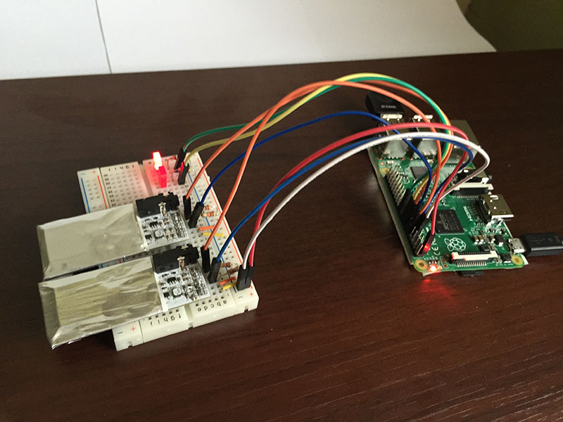

I just build a geigercounter from 2 pocket radiation-watch embedded sensors and an raspberry pi 2 counting them.
These are break out boards with a PIN diode and amplifier on it.
So basically all the raspberry pi has to do is count
(and make some graphs)
I used 2 sensors because the sensors seem a bit blind.
Even with 2 sensors i only get about 8 to 9 CPM. Calculating the uSv/h with the factor uses by the manufacturer i get around 0.07 uSv/h.

Mine uses the X100-7 sensor from "first sensor"
conversion factor to go from CPM to uSv/u is about 0.0189
So that is a lot less sensitive then a SBM-20 at 0.0057
I would need 3 of them to get in the same ballpark as a SBM-20
So price vs performance they are not really worth it.
If i realised beforhand i was going to need more then one sensor to get a decent CMP for background radiation i never would have bought 1.

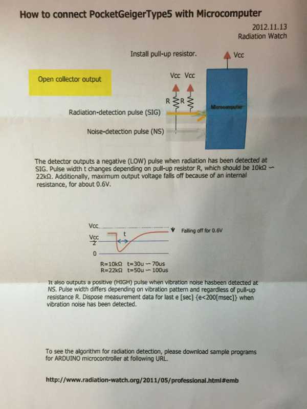

For the rest since mine came on a bob with an amplifier already on it they are pretty easy to use.
I just had to hook them up to a raspberry pi to start counting.
One other thing , the boards i have are sensitive to vibration and even loud noises.
There is a noise detetection and a radiation detection output on them.
When both go up that counts as a false positive and has to be discarded.
