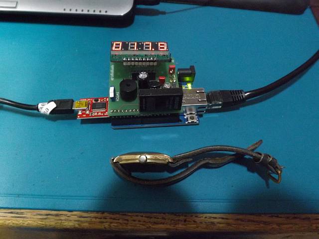

Hello everybody,
I joined the community a week ago with a station located in Stuttgart (hometown of Mercedes and Porsche) in South-West Germany. The station that feeds the data is a Pin Diode counter made from a Teviso module (see Teviso.com ). For this module I developed a shield that can be placed on an Arduino microcontroller board. I named it Tino (from Teviso + Arduino). On this shield I placed a 7 segment display module and a piezo sound generator to signal registered counts and alarms. I placed the shield on an Ethernet Arduino Board that gets programmed through a FTDI breakout and is removed after programming (see the attached picture). I put the whole into a water tight drainage tube, covered it with a blind plug and put it into the garden. The great advantage of the Pin diode counter is that it does not need a high voltage supply supply. It just needs 5V from the Arduino board a few resistors and blocking caps that's it. The detector module needs less than 1mA and you don't have to bother humidity and even water should not harm it. However, a Pin-diode counter has a much smaller count rate (this one 3.4cpm/uSv/h). So my Arduino translates this into an equivalent value for the SBM-20 tube (by applying the conversion factor of (0.0057uSv/h / cpm). So it appears as an SBM-20 tube but with much more noisy statistics as long as the rain is clean and not contaminated. However, in case there would be a fall out you would notice that the sensor will report values much faster. This is because I reverted the common principle how to calculate the rate. Normally the microcontroller counts the pulses for a given time. In my case the microcontroller counts 10 pulses and measures the time needed in order to calculate the rate. This way the statistics stays always the same (standard dev is mean / sqrt(10)). During normal times 10 pulses need about 15-20 min for a RD2007 module, so I have to wait this time for calculate the rate. But when a contamination would occur 10 pulses need much less time and the rate will be reported much quicker. According to the manufacturer an advantage of the PIN diode counter is that the energy response is almost constant from low energies such as the Am241gamma line up to high energies like the gamma line of Co60. An SBM-20 tube in contrast has some favorite energies in the low keV range which it counts better than other energies. A disadvantage of the Teviso module is that when you place it in front of a mobile phone it will give a high count rate as soon as the phone starts ringing. But if you know this you can avoid it easily and just use it to test the functionality without the need of a radioactive sample.
