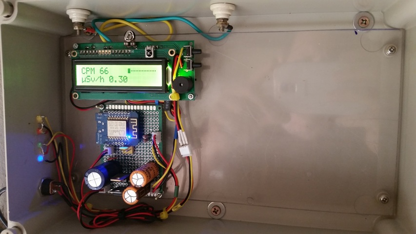

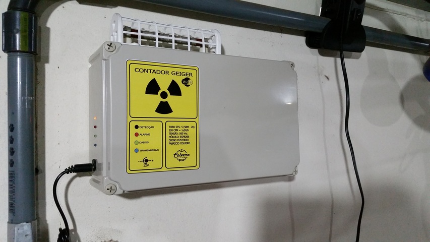

I have a STS-5 tube (beta & gamma) 220 CPM/uSV/h. Voltage 400V.
It is measuring outdoors, but protected from direct sunlight and rain, at height 2,10m.
I'm using an ESP8266 with custom software. It's sampling CPM every minute and I save the 10min average in a personal server.

Thanks for contributing, your data looks good so far. Maybe you made a small change to your setup in the last 24 hours, due to the 20% increase since then? It's a nice design with the GM tube exposed to the air, yet protected.
