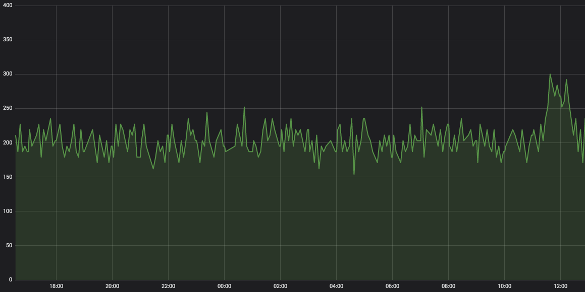

I did a new test today. The chamber is now wrapped in a few layers of aluminum foil and two zip plastic bags on top. It went from 200nSv/h to 300nSv/h if I put it exactly at the top of the tube (see the attachment). So I think it is safe to keep it around for future testings.

I find your results ever so slightly confusing. I try and use CPM in most cases for background monitoring as it is hard to get that wrong compared to using conversion factors. The conversion factor for a tube is usually only for one specific radionuclide so say the tube should be calibrated with Cobalt-60 and the conversion factor is given, it is just for that radionuclide which could skew the results for different radionuclides. I'll let you know when I get my J305 kit and we can work out some way of comparing them. Maybe I load your sketch onto an arduino of mine or something similar so we are both looking at the same output. I'll also have a play about with the voltage and see how their method of setting the voltage compares to my own. I made a 1000:1 voltage divider using a 1 gigaohm 1% resistor and calibrated using a few resistors in series for the other side of the voltage divider and seems very accurate. I have used that a few times for setting voltages in counters and appears to work very well with a 20M ohm meter.

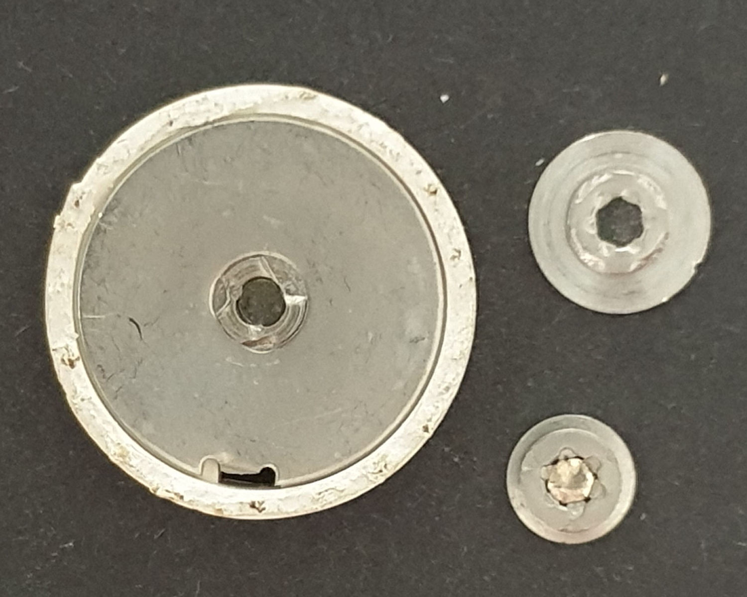

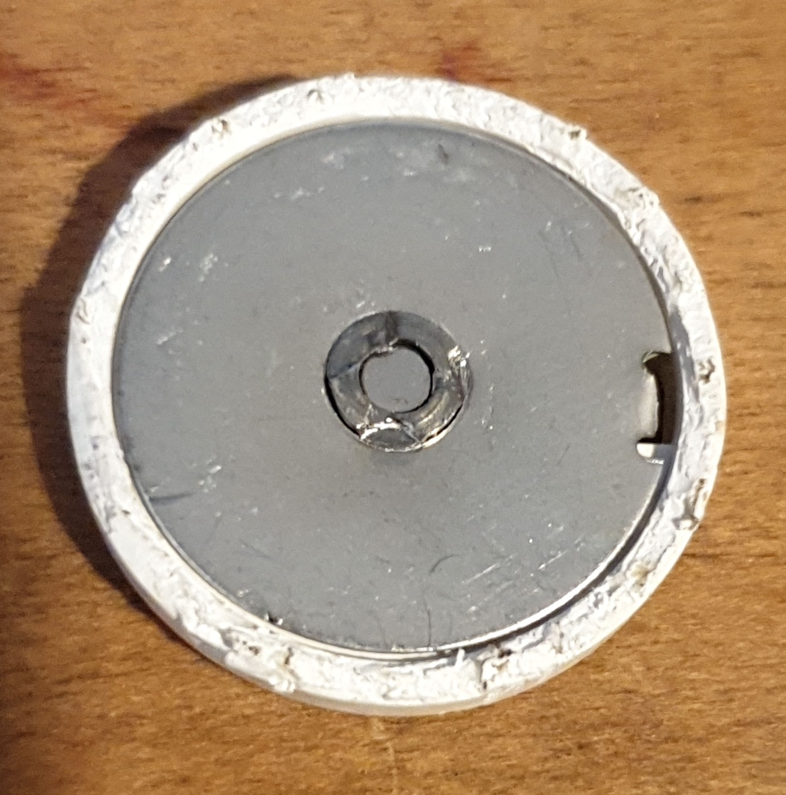

The first image is a better representation of the colours of the metal but the 2nd image looks like the AM-241 disc in the center is oxidizing. I suspect that wouldn't happen if it were either an alloy or gold plated. Mine are a plastic disc, not ceramic with the large metal piece that would be one connection to the smoke alarm PCB, then the little holder and finally the AM-241 disc in the center.
