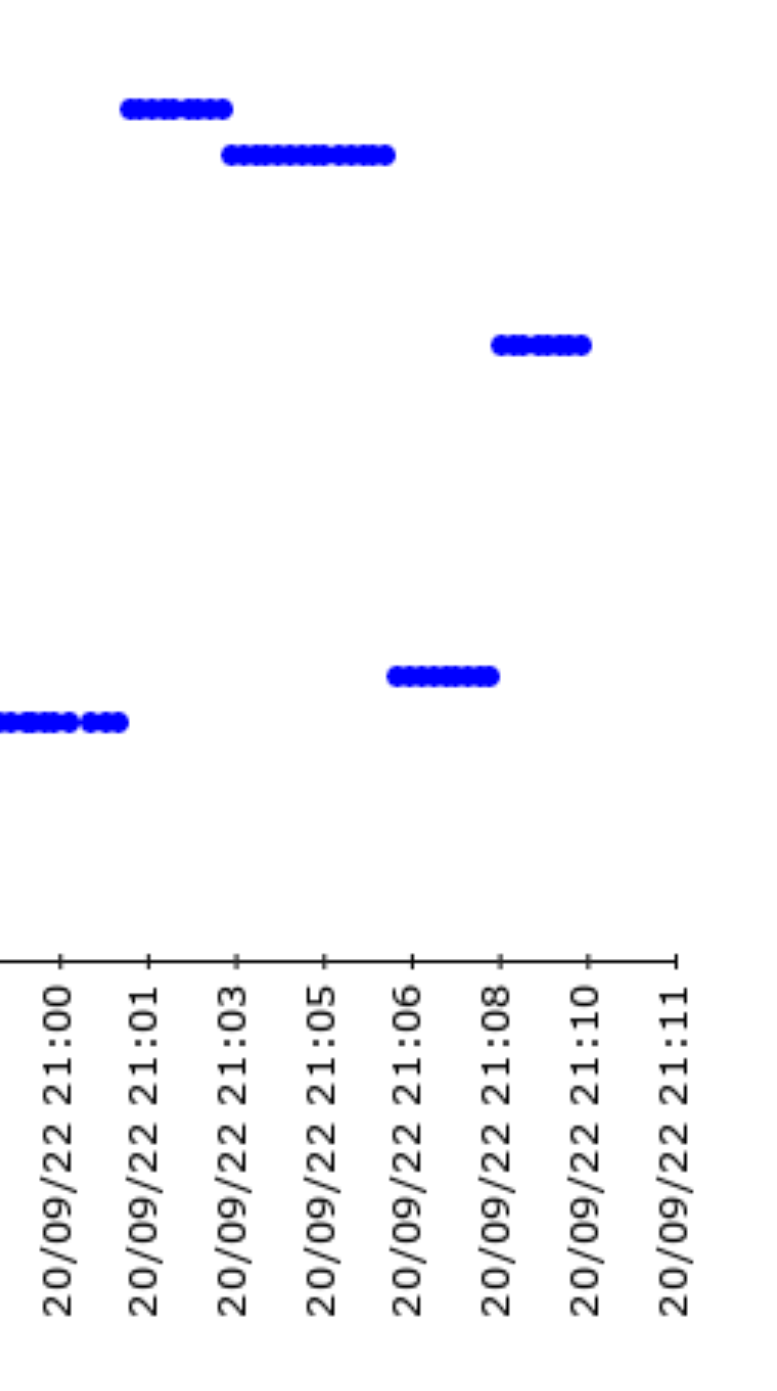

However, viewing the plot of the "Last hour of raw readings for deedee", it appears that your station is uploading each CPM value repeatedly, generating much more load on the radmon.org server than it should. You may have a software bug or a misconfiguration.

Thanks for yor reply. I can adjust the upload frequency. What upload frequency is right?
I have a multigeiger. The data are uploaded by a separate nodemcu, that runs an asynchronic webserver and also shows the value on an lcd. I need to add a separate procedure that handles the upload frequency.

Managed to fix it. The weird drops in my graph had to do with the procedure that grabs the value from the dataserver from sensor.community. Sometimes it has not yet updated, which means that my procedure returns 0.
I have included a condition that it only uploads a value if cpm >0.

Hi deedee and welcome to Radmon. Nice job fixing the drops issue. I think what nu3e was getting at is that your Radmon update procedure appears to be grabbing values from the dataserver about 8 x faster than the sensor.community database is updated (see attached image).
