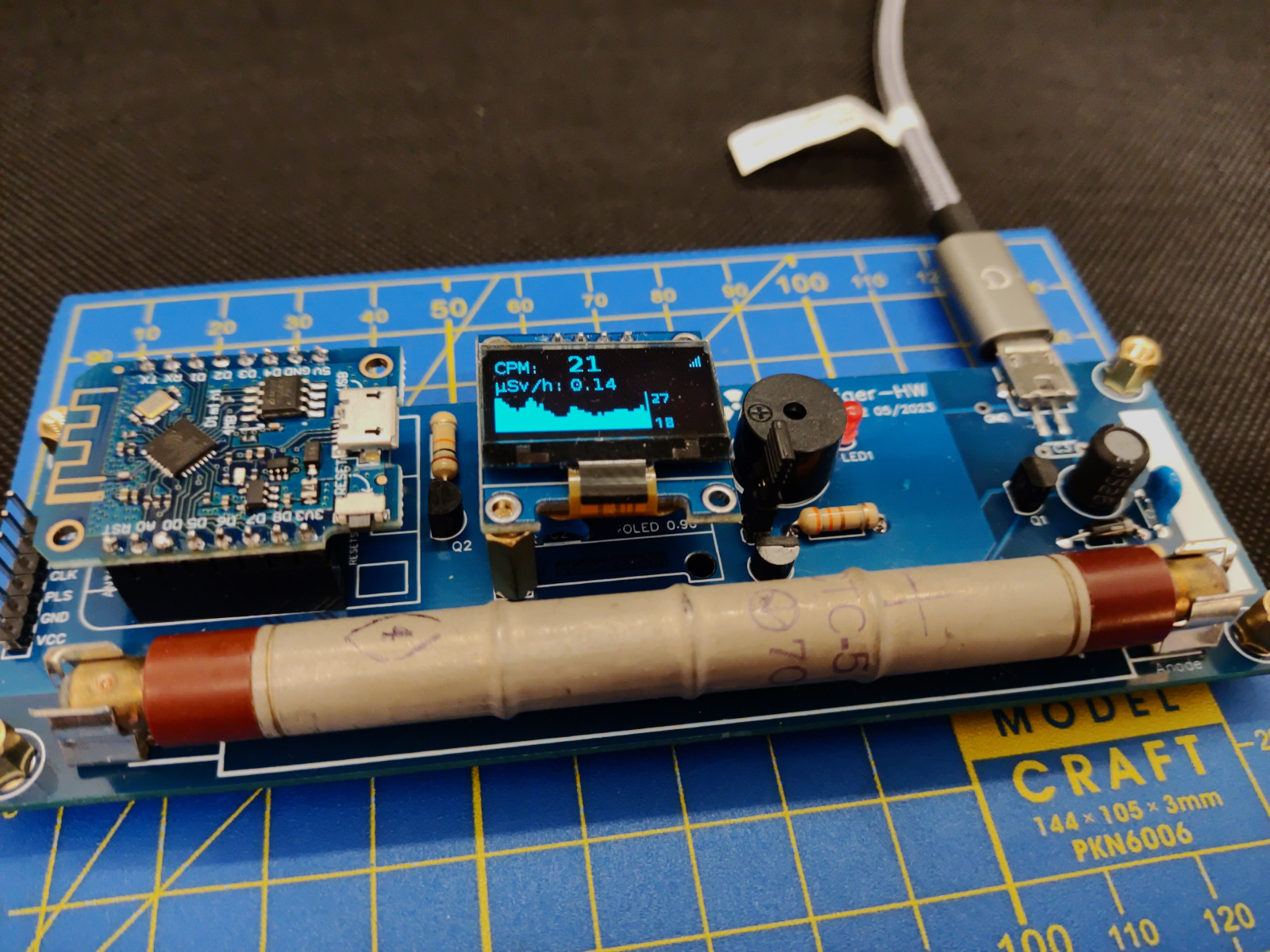

I have spent the last few months designing, testing and building a Geiger Counter built around the ESP8266 (controlling PWM for HV) as well as bringing the benefits of the ESPGeiger software - MQTT, reporting to radmon.org etc
Video

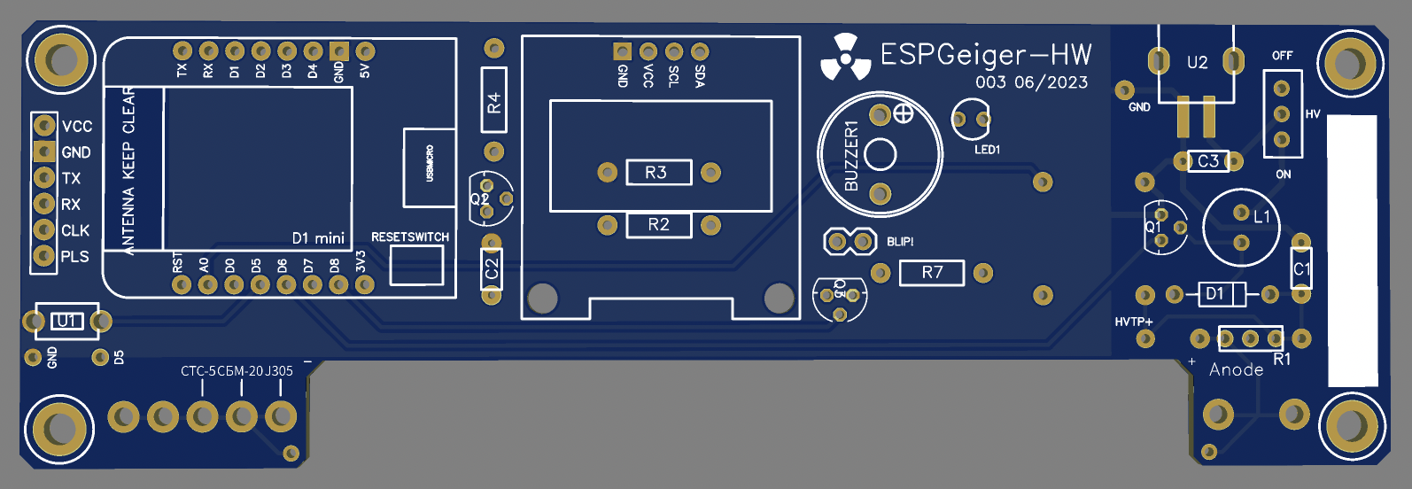

I have a newer version planned with adjustments to the PCB, cutting out the PCB beneath the GM tube and adjusting to add a user interaction button and switch for the HV side of the circuit. If anyone might be interested I can possibly look at supplying as a kit if there's interest?

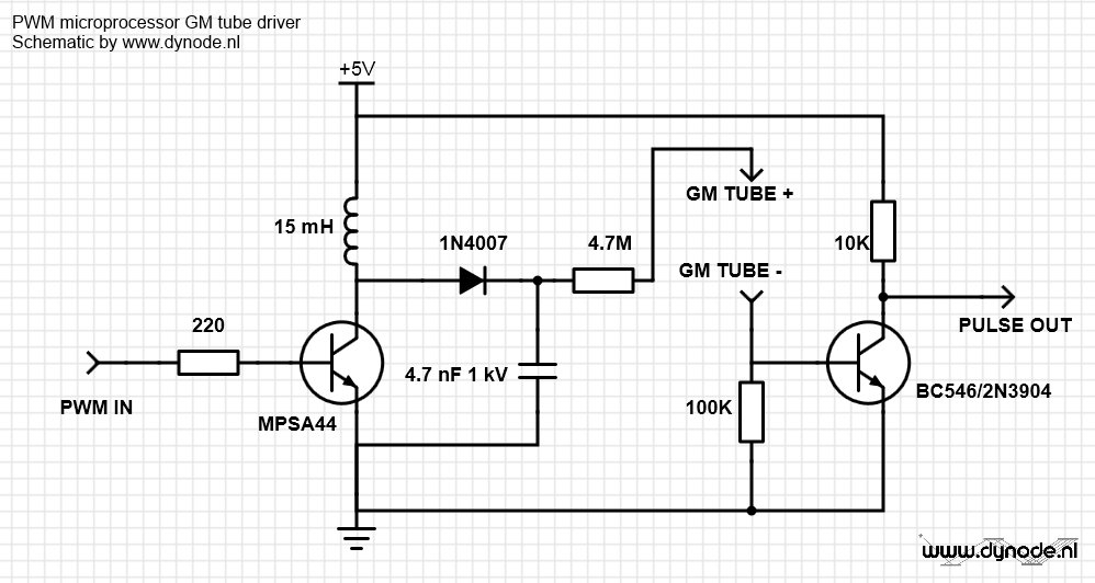

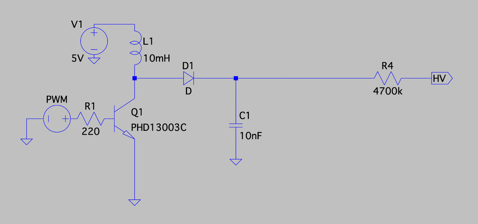

In any case - this is based upon the various designs around on the internet, but instead of a 555 for the boosting circuit, the ESP8266 does this job. See attached images for example of circuit using PWM.
Are there any thoughts for full testing on this? I've tested the boost circuit is capable of keeping up with the requirements of the tube at high counts. I'm happy to share more information and possibly looking for testers as well

I've taken delivery of the latest run of the ESPGeiger Hardware, this version includes a user input button, hardware switch for the HV side, optional swappable anode resistor and points for soldering external buttons and tubes.
I'll take some real photos soon -
Currently testing the latest hardware and making some software adjustments for the new hardware options.
