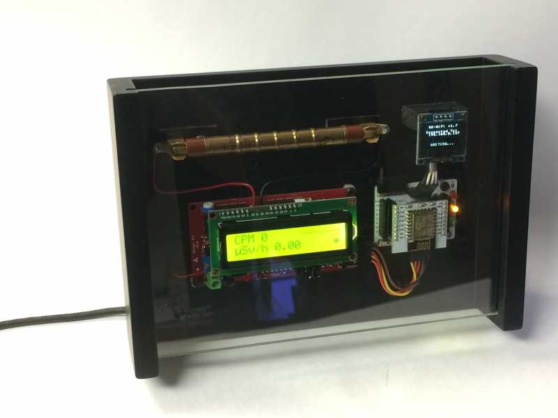

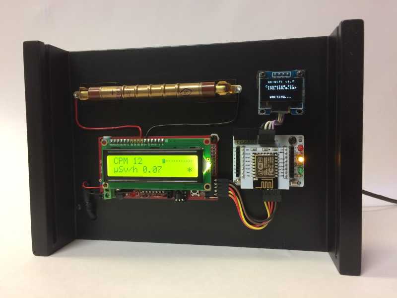

This GK-WIFI along with the GK-5B was a lot of fun to build! Excellent instructions and available information. It's nice that the kit includes extras! I have built many kits starting back as far as 1972 I have put together more than 17 Heathkits and another 10 or so Ham radio kits. I even built the Sol-20 computer back in the 70's
Today's kits are so much better with the instructions and HQ photos available via the internet. A high quality soldering station helps.
Attached are photos of the completed project to get up and running on Radmon.
Thank you John!
Great package!
Thank you John!
Great package!
