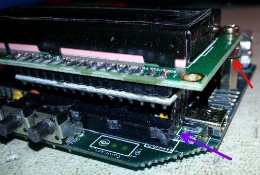

I have a Radioactive@Home detector (V2.61) that is has been working with the Radmon server via the 4-pin serial RS-232 connector 'CON1' for 10 months (I was never able to get my kit's USB port to work). This RS-232 connector uses TTL level voltages that require an adapter to connect to a computer's USB port. This product will do the job: <click here> or <here> *. This does the necessary conversion and provides a cable with 4 push-on wire connections for the detector. Here is a photo of the connector (it's the 4 horizontal pins between the 2 arrows):
The adapter has + and - 5V (normally red and black) wires for powering the detector; red goes on the + pin, black goes on the opposite end. The RXD white wire goes on the third pin from the top (TXD from the detector should go to RXD of the adapter). The green wire goes on the second pin, but this is optional as there is no data sent from the computer to the detector. With the USB adapter connected this way, the original USB cable is not required.
