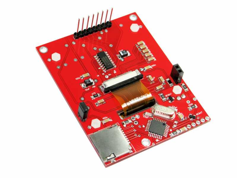

Optional add-on - microSD Logger shield for portable logging
the LCD shield is backward compatible with all boards.
