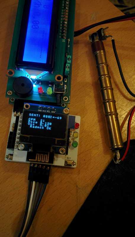

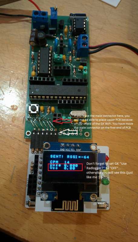

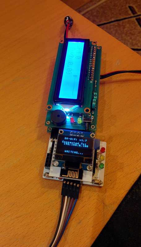

Aaaand the result is: Perfect! It work perfect!
We've tryied to connect BroHogan's GK WiFi Kit with my type of GK - Arduino IDE compatible DIY kit Geiger radiation counter and it work very well. This would not have happened without the help of John who given me advices all the time because there were few problems... because of me of course
Will add some pictures to illustrate how I switch on the system. I hope to be helpfully to someone, sometime
P.S.: To work correctly, you should connect 5V DC on the GK WiFi side. If you put 5 or 9V on the normal side - on the GK DC in - it wouldn't work with connected LCD shield and GK WiFi in same time (honestly I don't know why, probalby by voltage drop). On the GK WiFi board (on the bottom, male pins side) - the 4th pin is (+) and the 5th pin is (-) -> from left to right. 6th pin is unuseble. That's all I think. Sorry for the late edit
