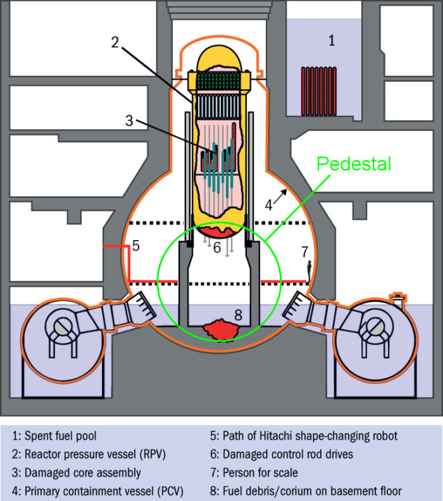

Looks like reactor 1 is going to crumble if something isn't done soon, and I doubt it will. It has taken 11 years just to get a robot down there to have a look. These are the first pictures from that part of the reactor. Basically, the concrete pedestal is the part that supports the reactor pressure vessel, with all the fuel rods, control rods and bits and bobs. If the pedestal collapses the reactor pressure vessel, along with what is left of the fuel will fall and contact the water. It will make it hundreds of times more difficult to try and remove the molten fuel on the floor as the reactor pressure vessel will be sitting on top of it all, along with what other debris that falls too. This is a diagram of reactor 1. I have indicated the pedestal in green. The videos are worth a watch just to see how bad it really is. One thing that comes to mind as to what would cause the concrete to erode and possibly not the rebar is Hydrochloric acid, or a similar acid. Without knowing what type of concrete was used and what type of metal/alloy the rebar was, I can't say for sure, but if an aggregate concrete was used this could explain the 'pebble-like debris'. Is it possible that during the meltdown something reacted with the water to turn it to acid?
