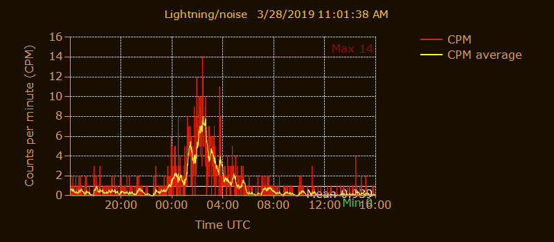

I have been using RadLog to record pulses from a lightning detector. Last night we had our first electrical storm for the season. Not a big storm, just some lightning here and there. RadLog produced a nice graph showing the results, image attached.
I am running two detectors on a Windows7 computer, one for lightning and one for radiation. This is working fine for me, thanks to mw0uzo's suggestion to use different Windows users, one for each instance of RadMon.
My lightning detector is based on a circuit found at http://www.techlib.com/electronics/lightningnew.htm#Magnetic
The pick-up coil is a roll (494 feet, 150 meter) of #34 enameled copper wire purchased on eBay. I put a small ferrite rod in the center of the wire spool. Resonance is about 10kHz.

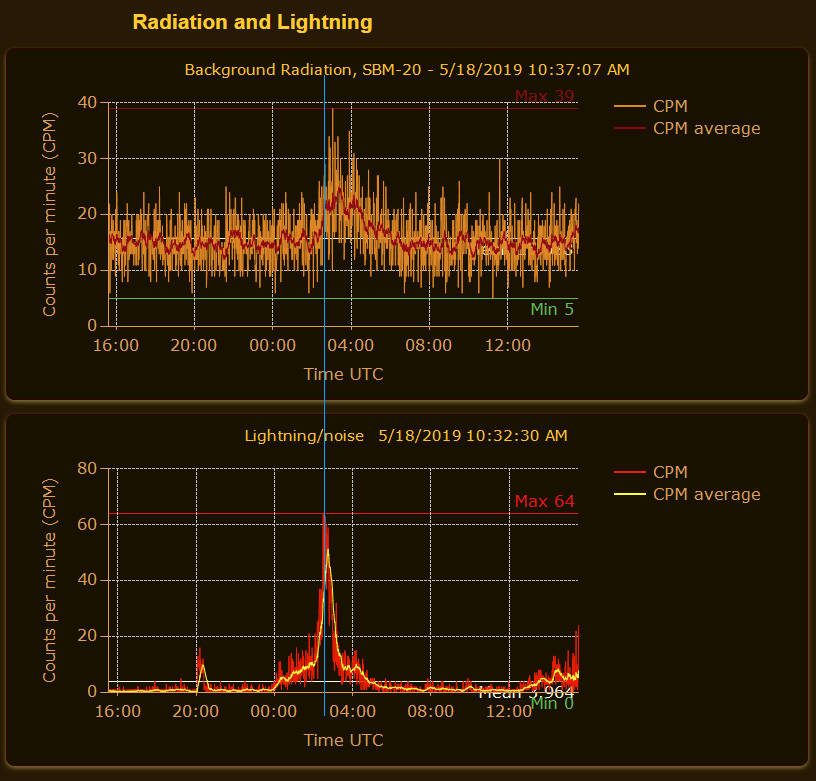

Interesting graphs showing lightning activity vs radiation. Rain arrived as the lightning peak. Radiation shows a small bump when the rain started. SBM-20 GM tube is mounted in a thin wall pvc pipe outside on a painted wood wall, about 20 cm above a roof. Lightning detector is indoors, a small coil of wire resonating about 15KHz.

Hey Chuck, nice plot of the two plots. You beat me to it, lol. I have lightning detectors here at the homestead and thought the same thing you did. Nice how you have the 2 plots in same image area. Are you uploading this somewhere on the web?I would like to try this as well. Oh, you mentioned something about putting you detector outside. I have a GMC-200 outside. Where on the forums area, I think I have photos of how I enclosed mine from the elements. I'm using one of them temp/hum sensor shields and its mounted inside it. Been like this for a few years now and still running. Do you have images of the coil setup you made for the lightning pickup? Frank
