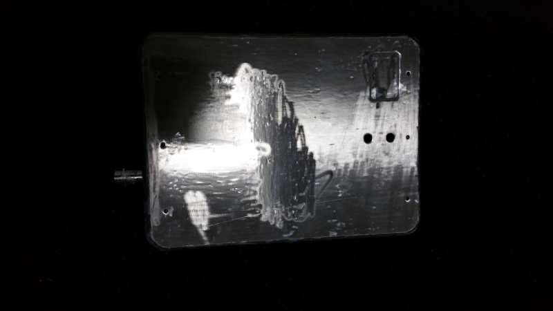

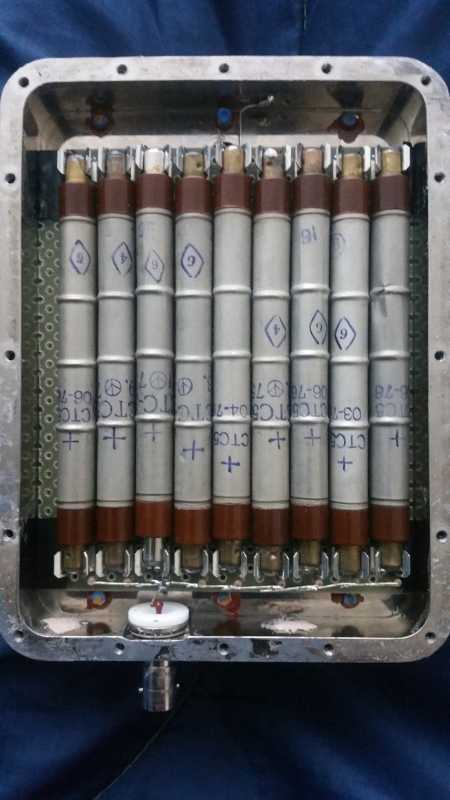

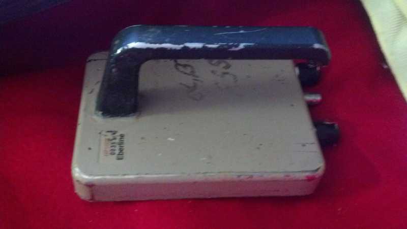

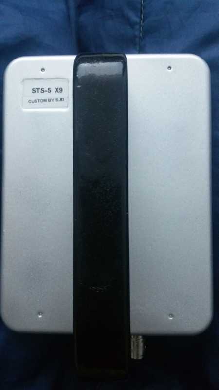

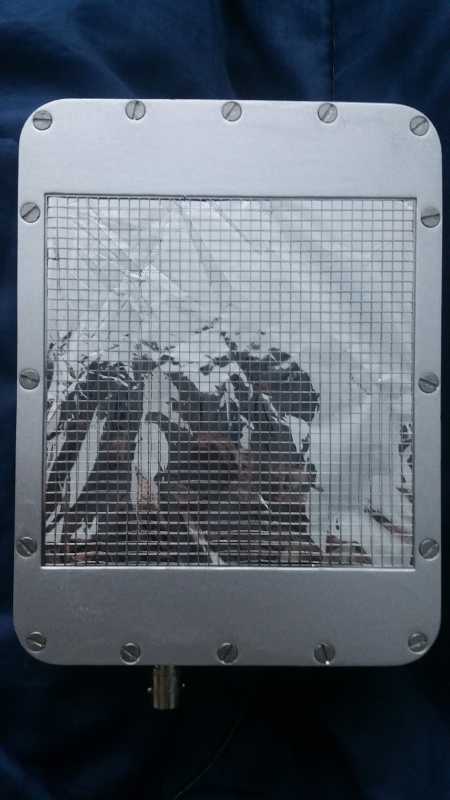

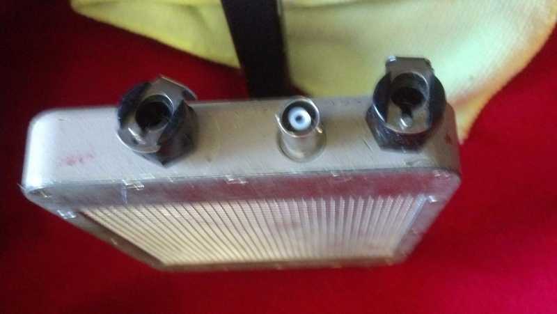

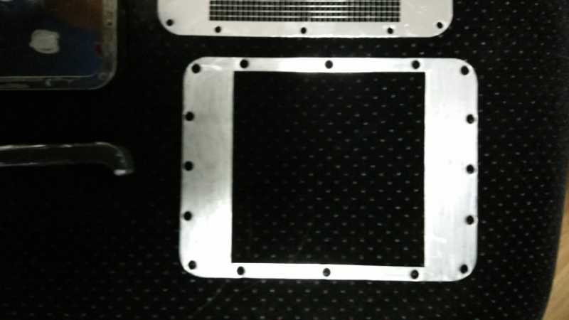

I recently purchased a emberline hp-100 gas probe not realizing it required a constant flow of argon and methane. Rather than resell it I decided to rebuild it using nine standard sts-5 Geiger tubes. here are before during and after pics of the project.
