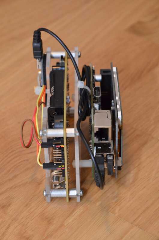

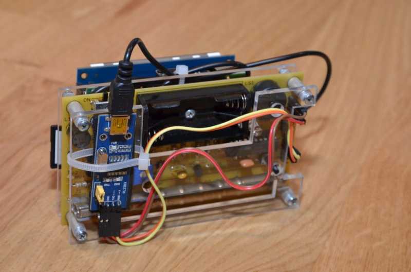

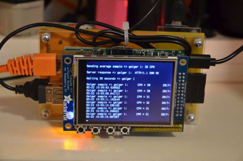

Now I finished some mechanical work
The Raspberry Pi is mounted with stand-offs to the back of the migthyohm Geiger counter. Now the RCA jack supports the whole thing from tipping over.
The Geiger counter is powered via the simple eb.. USB adapter.
Some pictures attached, this setup should run for some time now...
