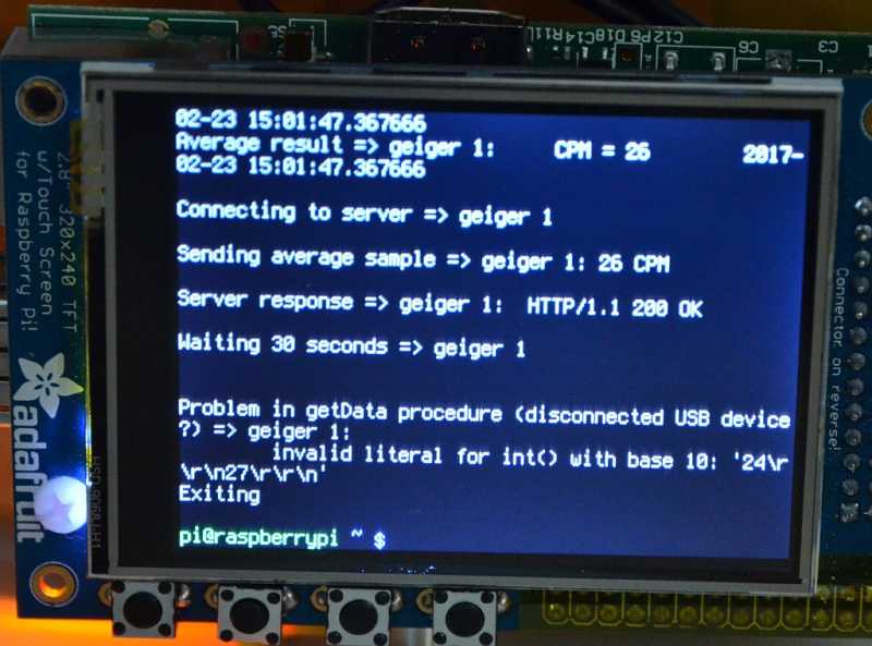

Bug
So there seems to be something wrong and before I spend hours to find it, I'll ask here.
Sporadically I do get the message shown on the "screenshot". Maybe every 12 hours or so, I had this very often in the beginning when the GC was sending data every second, then I changed it to every 5 seconds and it semmed to work.
What is the cause for this? Might it be enough to change the GC firmware to every 6 seconds or do I have to change something with the protocol?
PyRadmon is set to mygeiger protocol, the mightyohm ist just sending the CPM value and a CR/LF.
I'll change the timing again, but I would like the system to run stable for months in a row, hence a sporadic error stopping the logging is
Edit: I just have to restart PyRadmon to make it work again for some hours...

MyGeiger sends data every 30 seconds, this time shortens when the CPM reaches a certain level, then it jumps to 10 seconds IIRC.
I also see a double CR?

You're right there is a double CR
I've checked the code again and found two bugs I introduced last night during the modification.
Now it's sending (really) every 5 seconds and with a single CR/LF
Let's wait...
I've mounted the USB interface with stand-off, too. Looks better now.
Let's wait...
