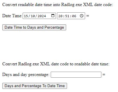

Alright, I got there and made a php page for converting the crazy time stamp (45578.87503472222222) in the xml to a human readable date and time, and also the reverse so you can generate the crazy time stamp from a given date and time. It's quite simple to use:
To generate a crazy time stamp simply choose the date and time at the top, and click the 'Date Time to Days and Percentage' button.
To decode a crazy time stamp simply copy and paste it into the box at the bottom and click the 'Days and Percentage To Date Time' button.
Usage cases; 'I want to find something in the xml file at a certain time date': Use the top section and punch in a date and time so you can see the readings around that time. It should get you in the ball park.
'I see something in my xml file and I want to know the date and time of the thing.': Use the bottom section and copy the crazy time stamp from the xml file into the box in the bottom section. It will show you the date and time in a human readable format.
Whilst this isn't a panacea for finding spikes, it should allow for getting in the ball park, getting somewhere close. It will still require some manual work browsing the xml file to find the spike, but it should get you reasonably close. I have a couple of other spikes in my long term log so I'll try finding them with this tool. But tomorrow. My brain is tired from all of those calculations.
There was one anomaly I came across. When I took a crazy time stamp from the xml, decoded it and then looked in the long term text file, the date was a couple of days out. I did this with the very last log in both the text file and the xml, so they should have been the same. Maybe not though as I'm not sure what the text file really does. It might be for shared data.
The tool is here: https://www.schmoozie.co.uk/radmon/time_tools.php
And source here for hosting yourself (.php):

</html>Attachments:
