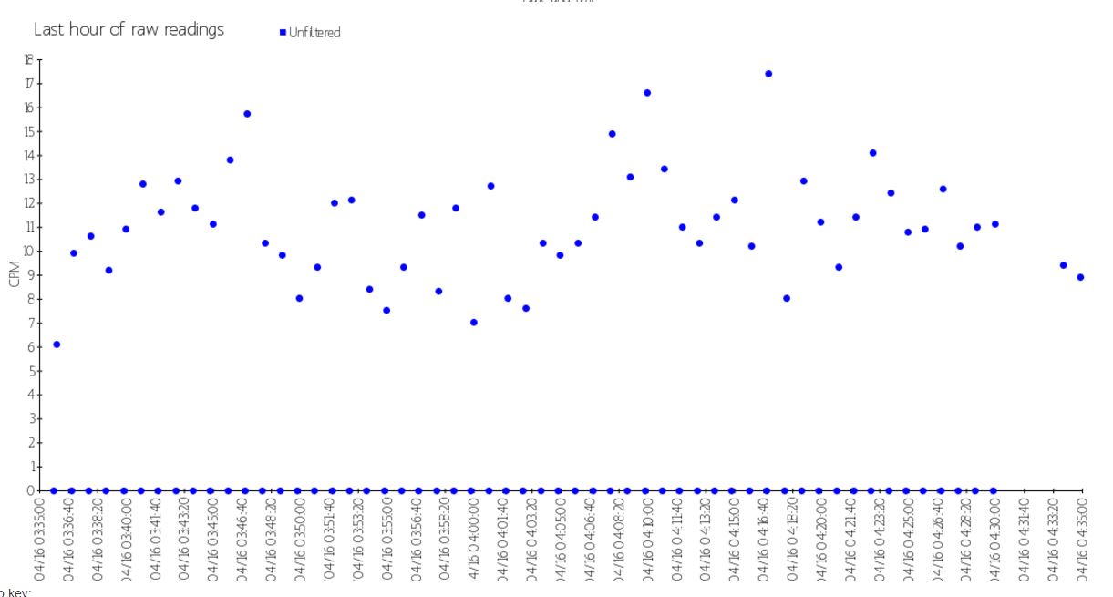

My readings alternating zero
10 years 5 months ago - 8 years 10 months ago #1989
My readings alternating zero was created by Bert490
After an offline test of my detector today, I stopped and re-started Radlog, and even though the software reported submitting the actual values, I just saw from the map that I was actually submitting alternating zero and proper values, resulting in this pattern. The graphs all averaged to half the normal value:
To restore normal logging I had to log out and log back in (Win7 Home Premium). Stopping and starting Radlog seems to cause these alternating readings. Not really a problem, just strange. But I think I've seen others' data appearing like this (can't recall who though). I deleted the last 6 hours of bad data.

10 years 5 months ago #1990
Replied by mw0uzo on topic My readings alternating zero
Ah ok, which version of RadLog?
10 years 5 months ago - 10 years 5 months ago #1995
Replied by Bert490 on topic My readings alternating zero
V0.41. I should mention that stopping and starting Radlog does not usually go cleanly for me (I usually just let it load upon logging on). After restoring it from the system tray, it does not appear in my task bar or in the 'applications' tab in task manager, but I can always <alt>tab my way to it if it is hidden behind another window. When it does not receive detector data or does not submit to Radmon (usually after unplugging the detector), I usually stop Radlog from the 'processes' tab in task manager, then re-plug in the detector, then re-start Radlog. The alternating display above is new to me. Could it be possible I was running 2 instances of Radlog without knowing it?
Addendum: I have not been able to reproduce this; it's working fine now. If it's just me, then it's it is not common enough to worry about. I can't find the other alternating user graph i saw before.
