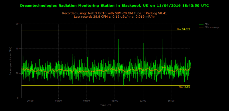

Since I have had my GC10 hooked up to Radlog I have noticed spikes anywhere betweeen 40 and 60 CPM. They seem to happen at random times or may not spike for 24 hours or so. I have two GC10's one with a proper SBM-20 and the other with a SBM-20u. I have swapped them around and still get the same. It also didn't change when I moved my monitoring counter outside and I still get strange spikes
Does anyone else get spikes like this? I'd like to hear of other GC10 users to see if this is a GC10 thing, or maybe it happens to everyone?

I also had those, however stations close to me had them also at the same time, so I guess something went supernova or something and part of it hit the earth.
Happens all the time.

Thanks for your reply DExUS.
At first I thought it was some kind of interference from some electronic something-or-other but after moving my counter outside and the same happening I got puzzled. I have another GC10 that I use as a mobile gps logging counter that I might put right along side of my outdoor counter. This logs the CPM every second to an SD card so I will be able to drill down and check the counts my mobile counter detected and compare against spikes in the graph.
It is not something I am worried about in the slightest, just very curious so I would like to get to the bottom of it. I had started to suspect they were erronious readings from the GC10 itself, but maybe not if others' experience the same. I also do have to bear in mind that my GC10 is a toy compared to proper monitoring stations and from what I ahve read the proper monitoring stations take an average reading over a period of time, such as an hour.
