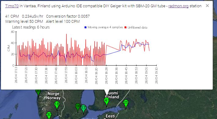

9 years 4 months ago - 9 years 4 months ago #3197
by Timo70
Replied by Timo70 on topic request for assistance: CPM bounces from actual to 0.
Hi there.
I'v struggled with the same problem for a while.
As you can see in the picture, first i had meny zeros and average was quite low.
I have had changed values of "Serial-audio counting period" to 30s.
Changed it back to 60s, and it seems to be ok, and average peaks up.
What really are the right values, please advise?
