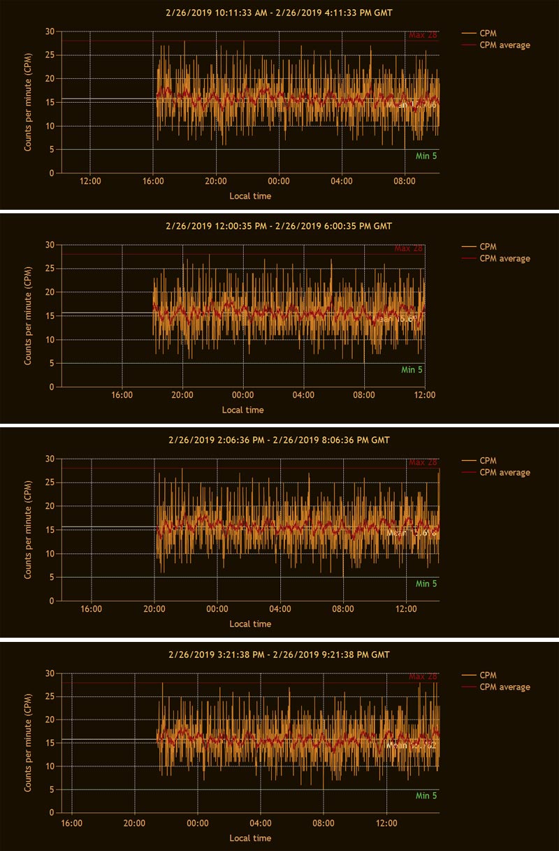

I have software set up to upload graph images to my website. In Graph Options, I have Log Interval set for 24 hours. It does not appear that the graph is working properly. Data gets cut off at about 18 hours. Please see the attached image to see what I am talking about. I know I can get a 24 graph at RadMon, but I like my colors and like hosting such things on my own site.

I think I found my answer for the graph cutting data off in "Problem with RadLog graph" It appears to be adding data to the end of the graph now that I set the time for UTC. Would prefer local time, but this works..

I think I was seeing the same problem that was discussed in "Problem with RadLog graph" on my 0.43 version. Data being cut off the old end of the graph. The original post shows what I was seeing. I am GMT-6 and unchecking the GMT box cured the problem. Not a big deal, but local time would be a nice touch.
