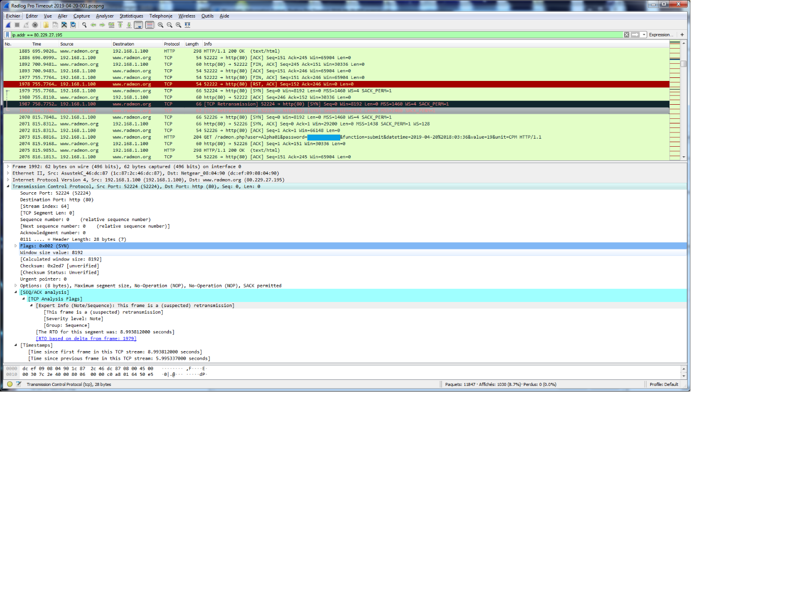

7 years 4 months ago - 7 years 4 months ago #4395
by Alpha01
Replied by Alpha01 on topic Whoops outage yesterday
Hello,
Finally I could record one event using Wireshark.
It seems that the server completely miss the opening of a connection (port 52224 in the attached picture), the first attempt failed, but also the two following retries 3 and 9 seconds later. Of course as the connection failed to establish at the tcp level, no http request could be sent, reason whyradmon Radlogger Pro reported a timeout.
The previous one (port 52222) and the next one, 60s later (port 52226) were successful.
I let you investigate on your side if you could confirm that...
Kind regards,
PS: I noticed also several retransmission attempts at different level (often a missing ACK) and systematic RST to close a previous connection just before opening a new one (don't know the root cause).
