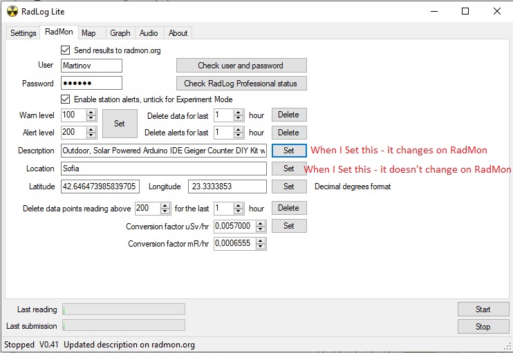

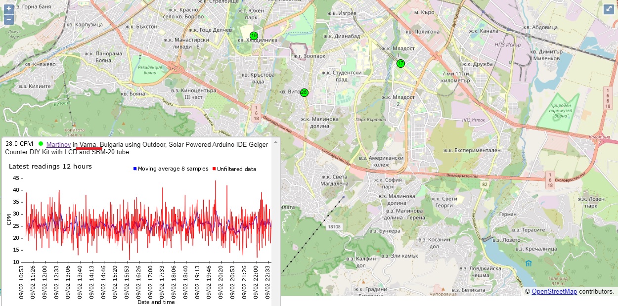

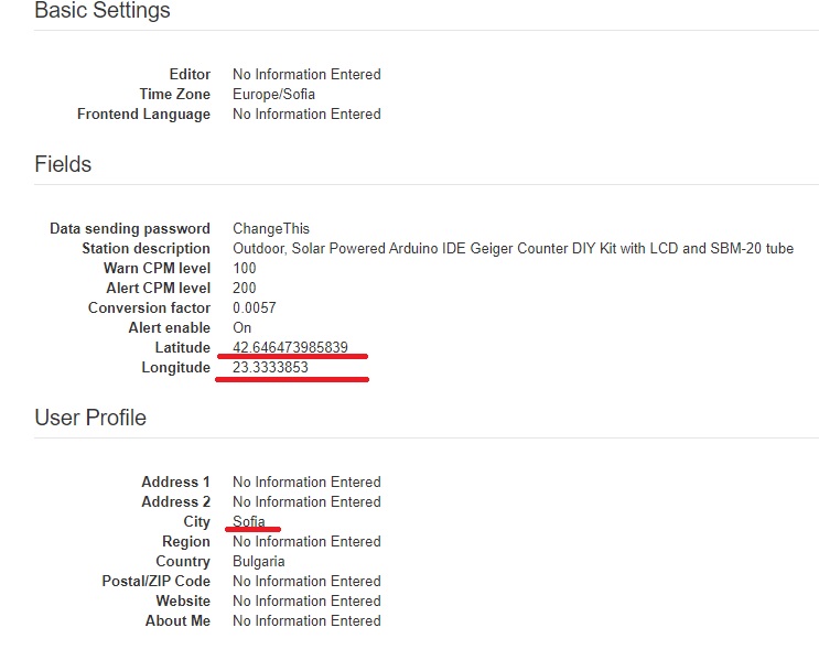

Hello! I just logged in with my new username. This time I was able to make and save some changes in "Station description"  and "Location" gap, but nothing changed on the map. I also tried to change it through RadLog but it didn't change the location on the map again. Hm... I'm out of ideas what else I can try?

I'M really not sure why the changes are not propagating to the back end. I have manually changed your address so things should be right for you now. I will have to have a look to see what is failing.

I have just noticed that you are running Radlog version 0.41. I suspect that is why the location didn't update when you changed it in Radlog. You could try updating to 0.43 and see if that fixes the issue of the location not updating with Radlog. The location not propagating from Joomla is a separate issue I think. I should make the changes (if any) when the station submits a reading, so I'll have to look into that.

Thanks a lot for your support! It's already changed. To be honest, I tried to make some changes using both version 0.43 and version 0.41. I saw that version 0.43 doesn't have "set" button and Station Description was changed with no issues through version 0.41 but not the location. However, everything is okay now, so again - Big Thank you for your help! Cheers!
