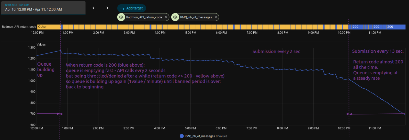

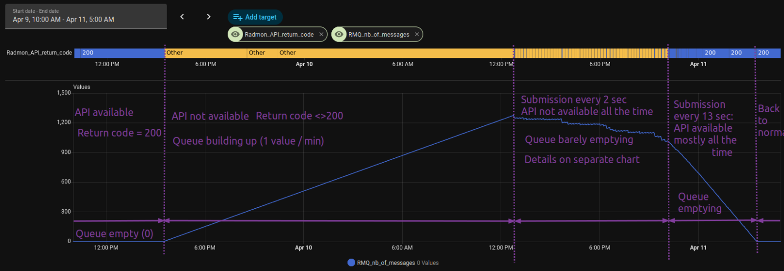

I have 2 graphs trying to explain what happens when I submit every 2 sec and 13 sec. They are from the Home Assistant dashboard and this is where I see if the uploading process is working.
Hopefully they are self explanatory. If not, I can provide more details.
As for the error code, I catch it, but I don't store it. So I don't know what was exactly in the message.
I just check if the return code is different from 200 and if it is, that is what I call "API not available".
The value I was trying to upload is then put in a queue to be re-uploaded later.
As for the API call, I use the syntax with datetime:
http://radmon.org/radmon.php?function=submit&user=radmon_user&password=radmon_password&datetime=UTC_TS&value=CPM_value&unit=CPM"
Hope I have not missed anything.
